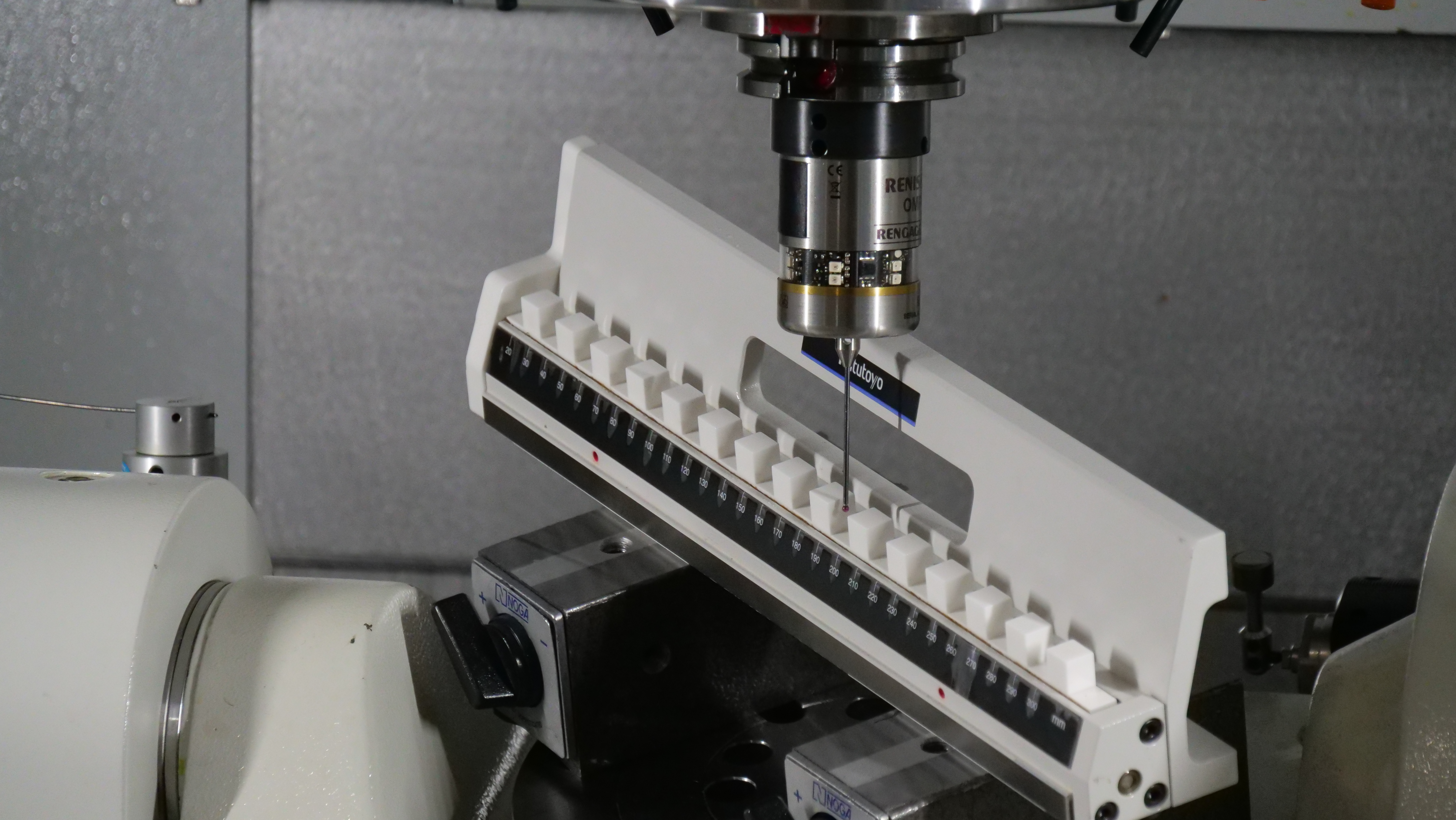

KES is also an advocate of Renishaw’s machine tool probing systems
KES is also an advocate of Renishaw's machine tool probing systems
