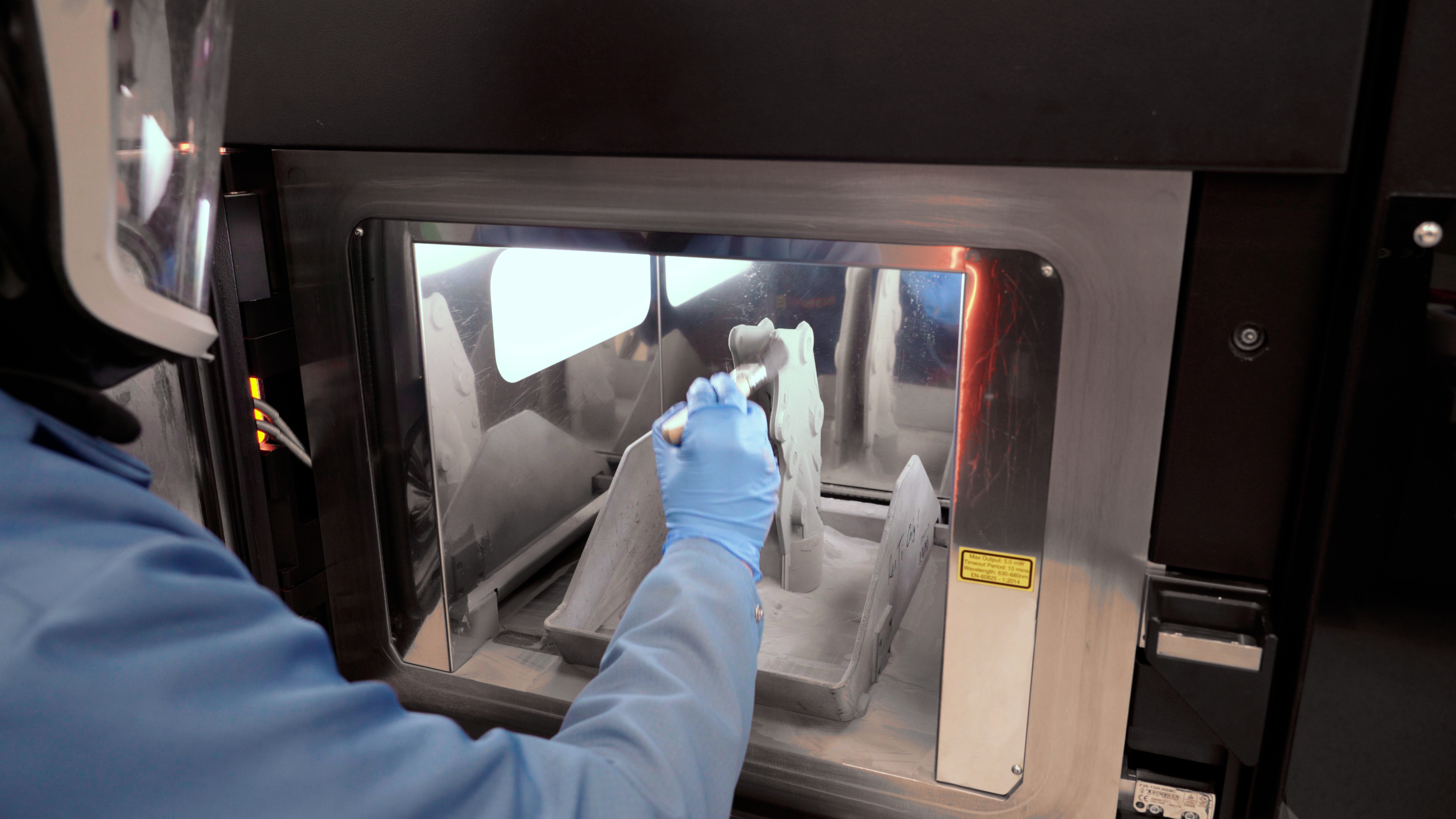

INEOS Depowdering

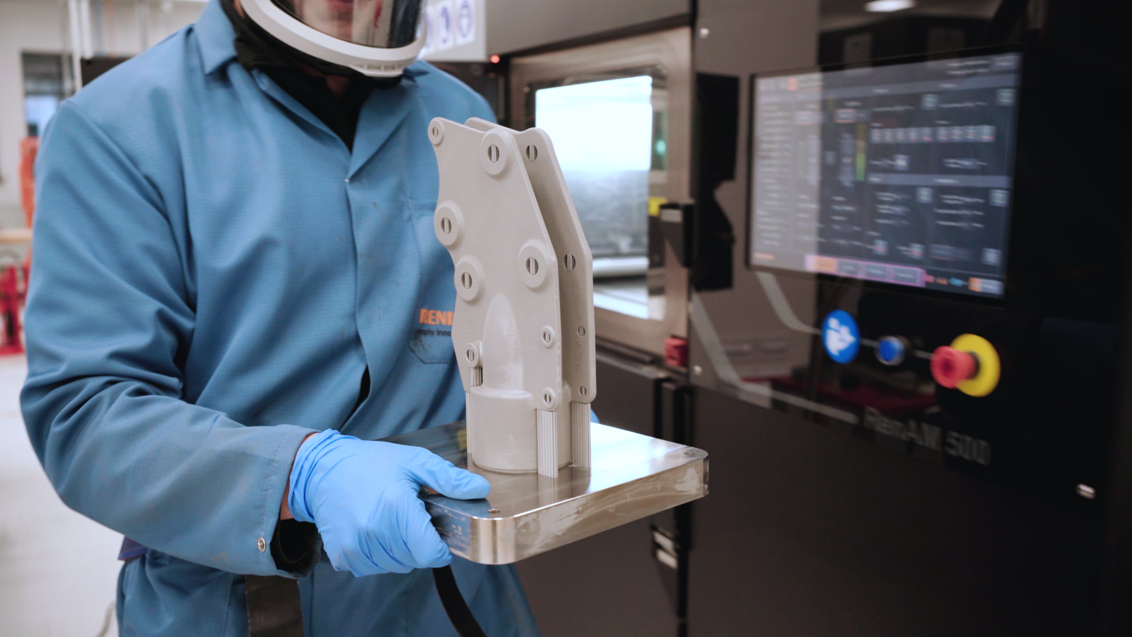

INEOS Britannia uses additive manufacturing (AM) processes to manufacture some metal parts such as the ‘mainsheet sheave end'. AM is a versatile manufacturing technology that allows near-net shape production of a wide variety of complex functional shapes. It offers exciting new design opportunities for combining and optimising parts, potentially reducing tooling and material costs.
In this application, AM can significantly reduce the waste, scrap and embodied carbon* associated with the manufacture of parts, when compared with traditional CNC machining.
INEOS Britannia has used Renishaw's RenAM 500 AM systems to manufacture numerous metal parts on its race and test yachts.
Worked example
To highlight the power of AM techniques to minimise the embodied carbon* of metal parts, Renishaw has performed a like-for-like comparison of CNC machining and AM manufacturing in the production of the mainsheet sheave end for the T6 test boat. The AM process delivers an eight-fold reduction in carbon intensity compared with traditional CNC machining.
A significant contribution to the embodied carbon of the machined part is the energy used for machining and removing a large amount of material . The titanium billet required for the CNC process is 8.5 times more massive than the powder required for the equivalent AM build. In this case, CNC machining generates 19.7 kg of swarf waste material.
