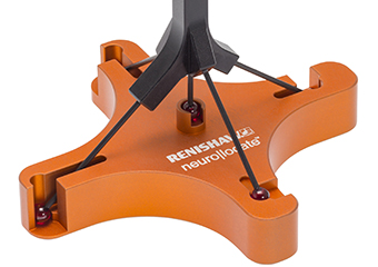

neurolocate checking gauge
1. At the start of the procedure, the checking gauge may be used to check the geometry of the fiducial marker frame.

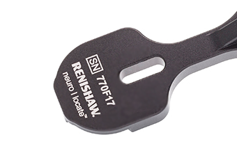

neurolocate serial number
2. The fiducial marker frame is identified within the software (using its serial number), to load the correct calibration parameters.

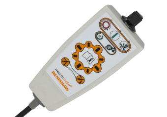

neuromate remote control
4. The fiducial marker frame is moved into an optimal registration position using the neuromate remote control. The kinematic mount from the fiducial marker frame also acts as a safety feature if the robot is moved too close to the patient.

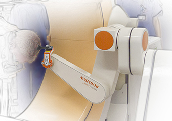

neurolocate CT acquisition
5. Either CT or X-ray image acquisition is performed and subsequently loaded into the planning software. Fiducials are identified and the registration process is completed.
