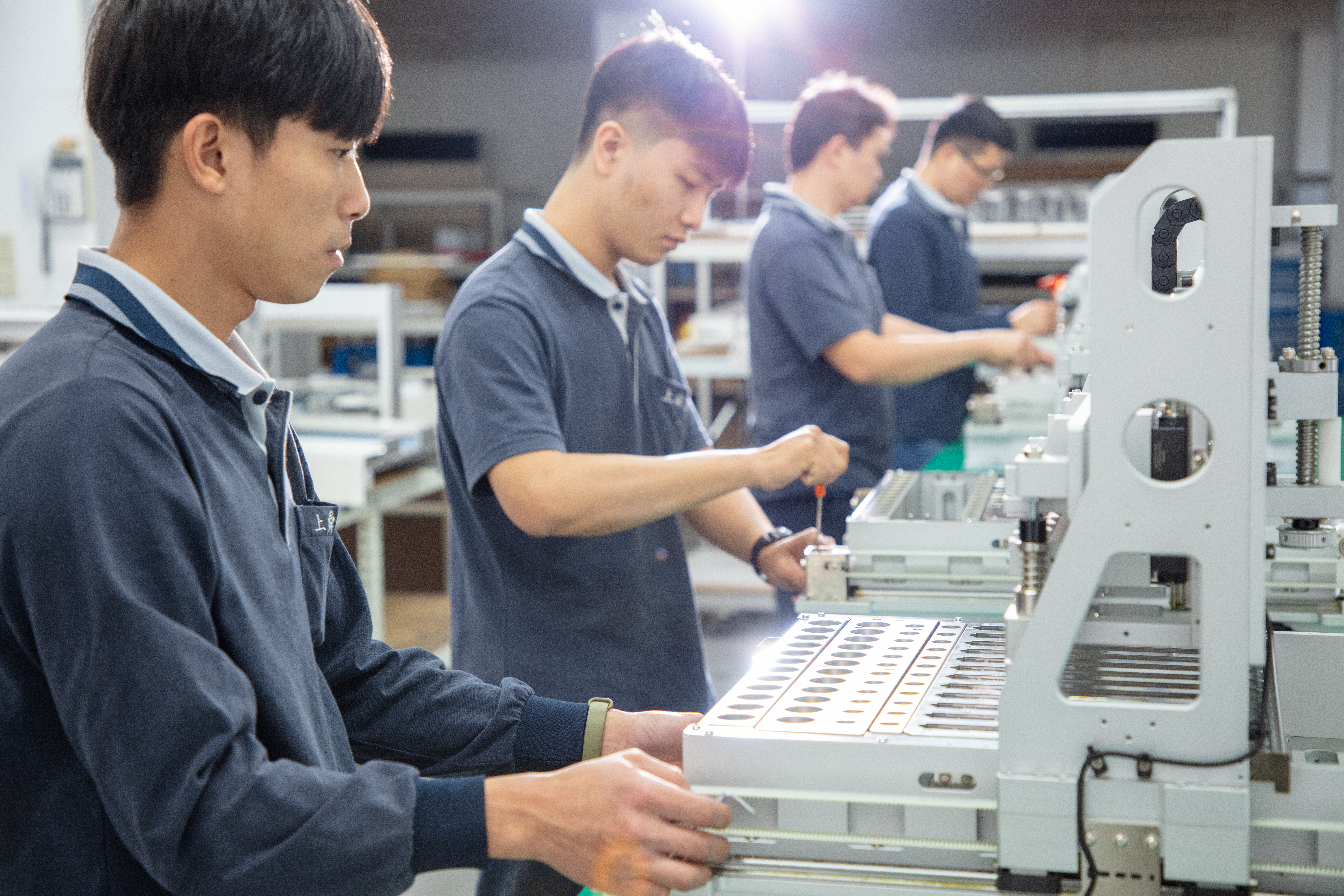

Smooth Precision is a specialist equipment manufacturer based in Taichung, Taiwan. Established in 2009, the manufacturer develops and produces specialist equipment for processes, such as glue dispensers, pressure testers for smartphones and automation equipment. The company has now become part of the supply chain for market leaders in smart mobile device manufacturing.
Smooth Precision's specialist equipment production line
