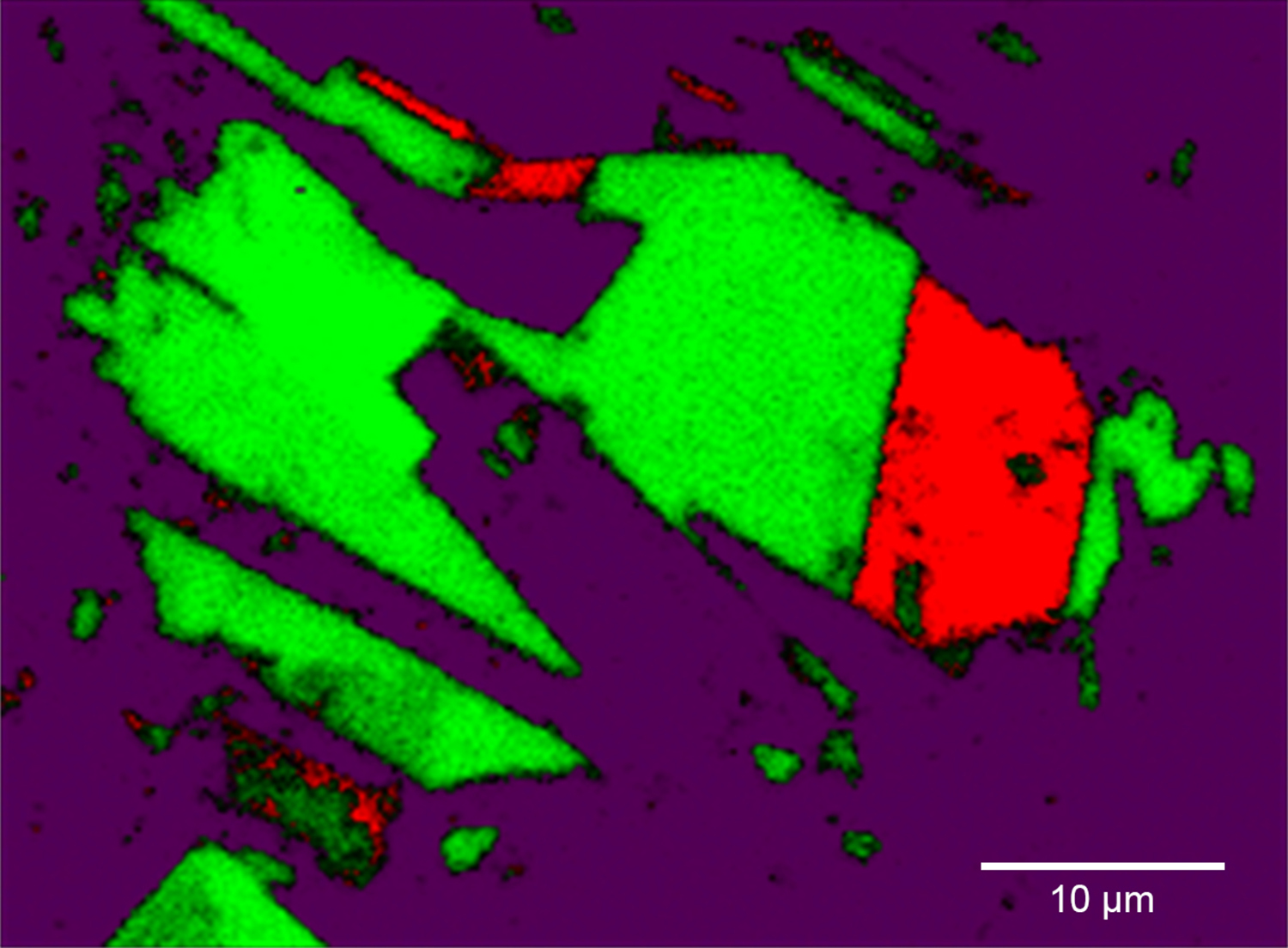

White light and Raman images of graphene flakes on a silicon substrate. The Raman image is colour coded by number layers in the graphene: single-layer (red); dual-layer (blue); and multi-layer (green).
