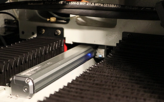

FORTiS™ enclosed encoder inside TGT's tool grinding machineFORTiS™ enclosed encoder inside TGT's tool grinding machine

Tubular linear motors are employed on the crosswise X-axis and the longitudinal Z-axis of this machine with strokes of 300 mm and 680 mm, respectively. Both axes are equipped with the FORTiS-S™ enclosed encoder system, which is the standard-sized variant of the FORTiS encoder.

Mr Ranganatha explained, “The installation of the FORTiS enclosed encoder is very simple, which has greatly improved our productivity. Using the ADTa-100 tool and after receiving the appropriate Renishaw training, our engineers can complete a single-axis installation in only 15 minutes. If only the readhead LED were to be used, I believe the speed would be even faster. The LED allows us to quickly determine the status of the encoder, improving diagnostic accuracy when the machine is faulty.”
