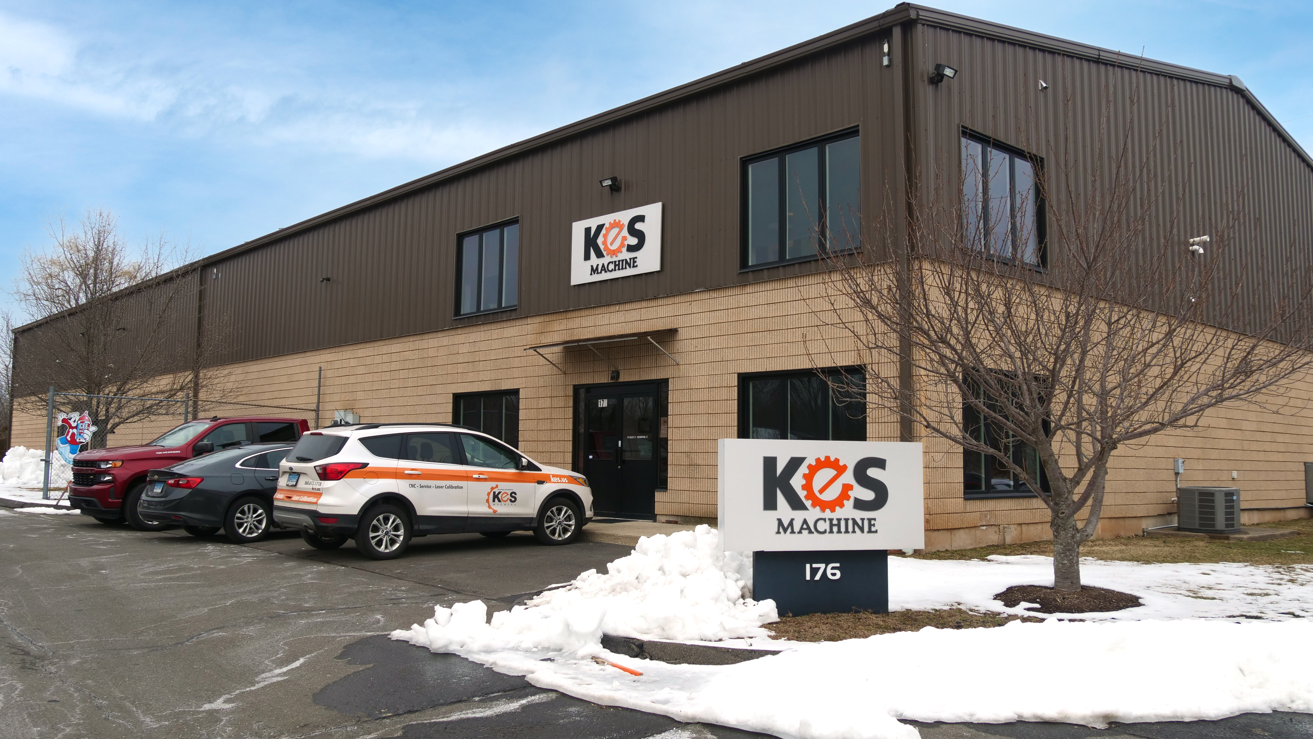

After moving from Poland, in 2000 Greg Kordalski founded KES Machine LLC in Connecticut (USA). Since then, the business has been helping engineering and manufacturing companies maximise productivity and minimise downtime with its accredited calibration and repair services. KES Machine LLC's technicians help machinists solve geometry errors, lead screw errors and repeatability concerns — sometimes the team can diagnose errors before they become critical problems, saving downtime.
While the company initially focused on CNC service work, in 2008, it invested in its first Renishaw ML10 laser system and began developing its calibration services. Based in Newington, Connecticut, the company works with machine tool builders, importers, distributors and end-users, primarily in the aerospace, defence, nuclear and medical sectors across the region.
In 2019, KES opened a Polish subsidiary to support manufacturers there. “Since I was born in Poland, I visit quite frequently, so this is why I chose Poland as the first country on the European continent.” explains Kordalski, founder of KES. “However, this does not mean that the expansion of the company in Europe will be limited to Poland.”
The company offers in-house and on-site repair services, as well as monthly maintenance contracts to keep equipment operating at optimal efficiency and accuracy. In 2016, KES obtained ISO 17025 certification and became a fully capable calibration service company.
