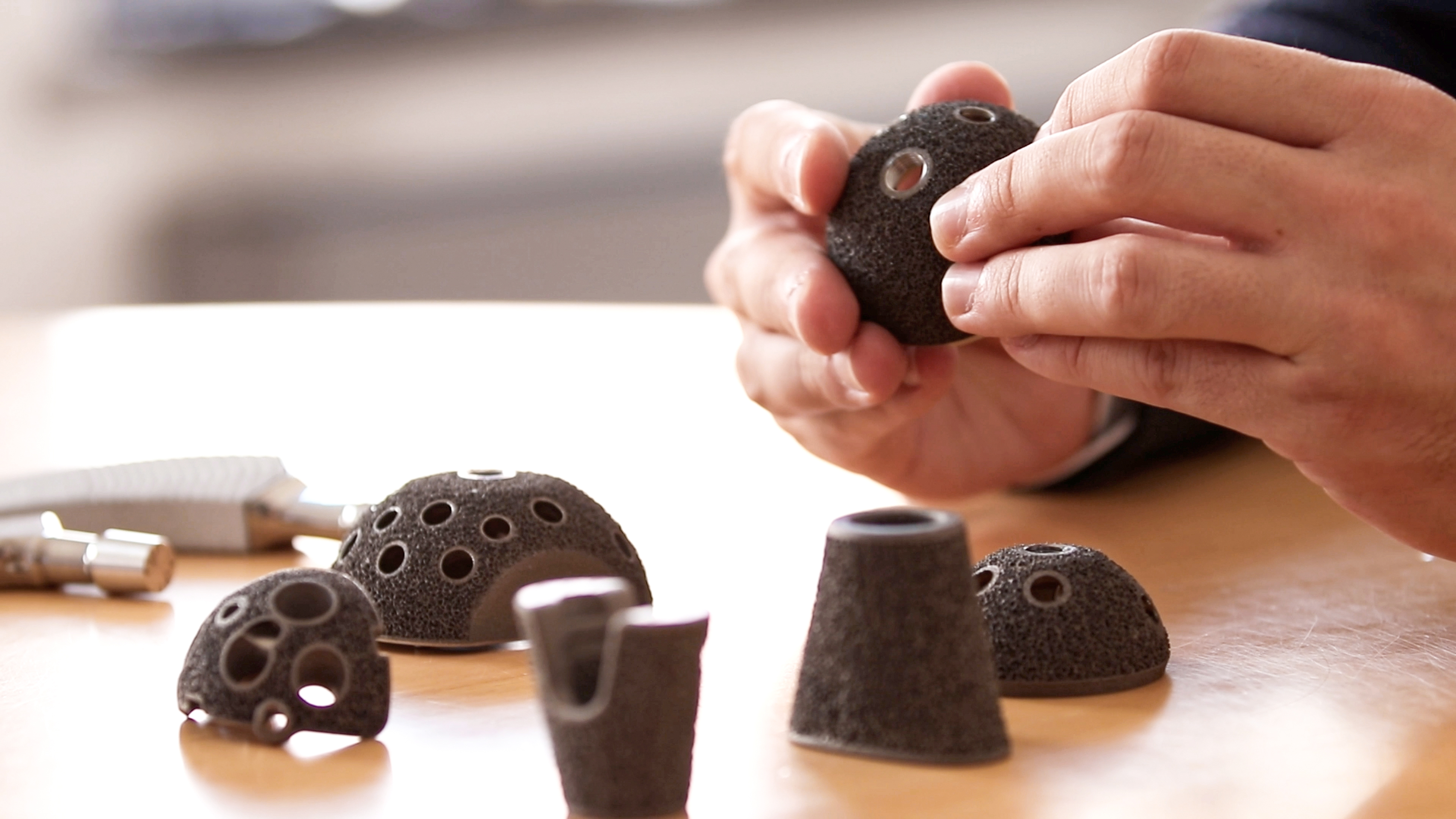

In recent years, Permedica began using AM alongside traditional production methods. This approach allowed the company to condense the production line while opening up the possibility of creating bespoke products for individual patients.
"Product customisation is, for all intents and purposes, still a small niche of the market," continued Perego. "However, it has two great advantages: the first is that is broadens our capability, and the second is that it is probable there will be a strong push towards it from an engineering perspective because it is where the market is heading. So, being at the cutting edge of it is crucial."

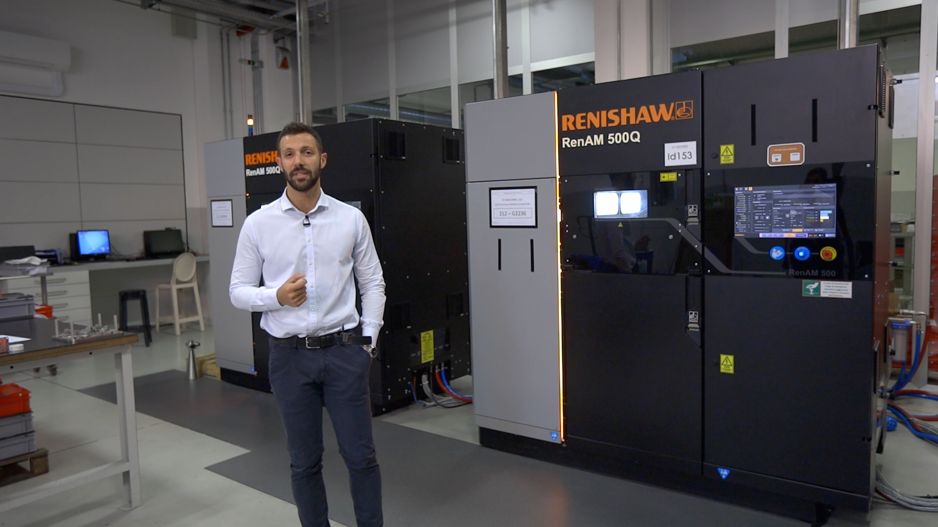

When searching for a new AM machine, we found ourselves looking closely at the Renishaw RenAM 500Q and it immediately struck us as a very interesting solution. This was down to several reasons, first and foremost the production area, which has impressive four sintering lasers. This feature allows us to achieve a remarkably higher level of production and a reduced cycle time per unit produced as compared with the single laser machines we already had in our workshop.
Permedica S.p.A (Italy)
Perego explains, "The RenAM 500Q is a fully automatic machine, including powder sieving operations, meaning that there is no need for operators to oversee this step, saving a great deal of time. Due to our existing relationship with, and knowledge of, Renishaw, we knew that this was the product to go for."
By speeding up the process by up to four times, the RenAM 500Q broadens the market appeal of metal additive manufacturing into applications that were previously uneconomic, driving the technology into new industries. The RenAM 500Q is designed to scale up AM technology to suit larger production volumes, enabling Permedica to use the system for mass production of standard parts instead of custom applications. Its working volume (250 x 250 x 350 mm) and four lasers enables the company to meet demanding production volumes and speeds. The system also features automated powder and waste handling systems that enable consistent process quality, reduce operator intervention time and ensure high standards of system safety.
Four 500W lasers enable RenAM 500Q to provide large volume production

By installing the RenAM 500Q, Permedica experienced increased throughput and found that the mechanical properties of parts manufactured on the machine were superior. This enabled the company to extend the production of other parts using AM. Permedica purchased two additional RenAM 500Q systems in 2022, allowing them to meet increased demand for mass produced medical components in the healthcare market.
"The presence of the four lasers effectively puts us in a position to operate with significant production volumes," explained Perego. "This expresses just how versatile the Renishaw machine is, making it the crown jewel in our production setup."
