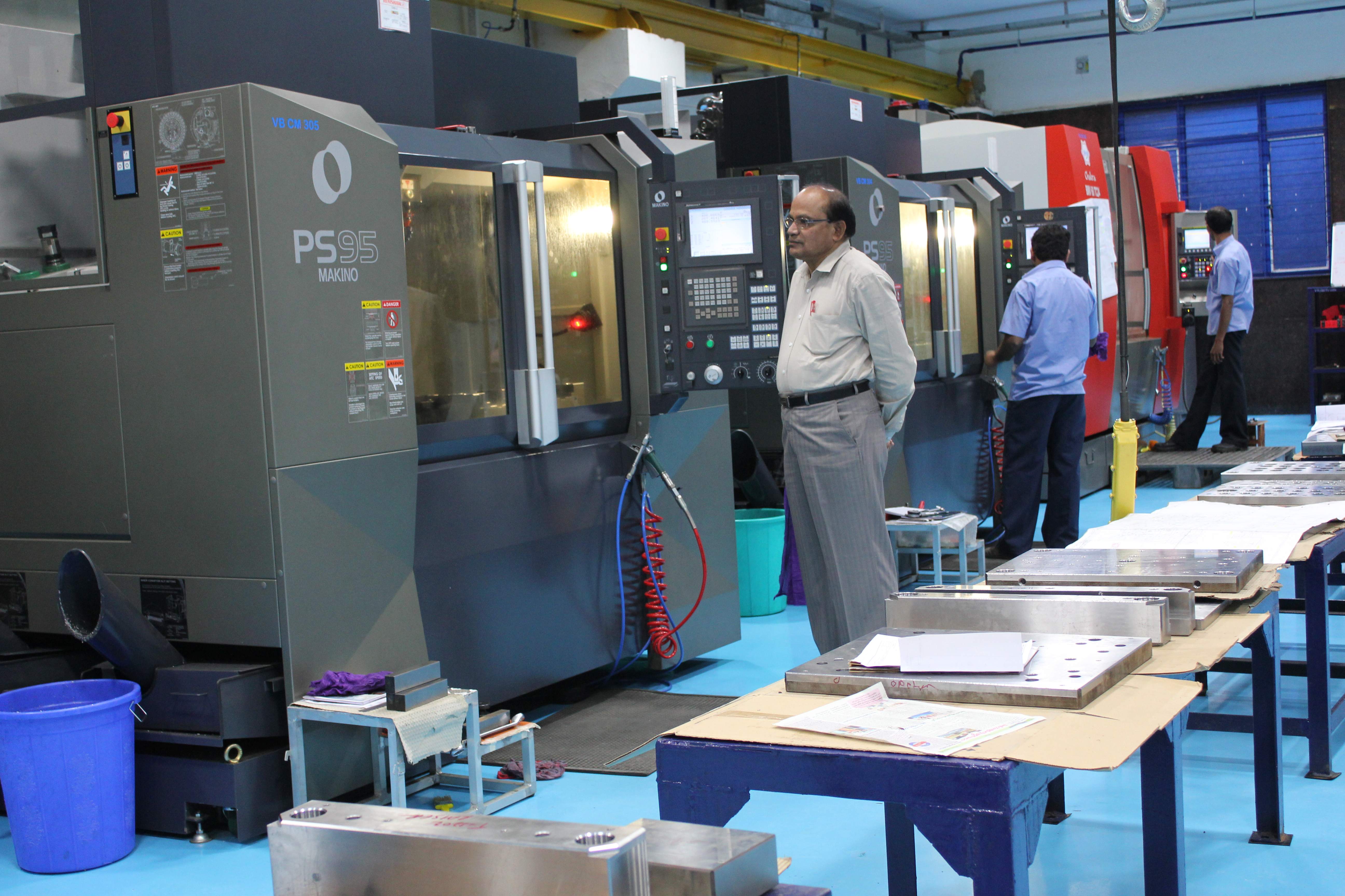

With the help of Renishaw's RMP600 touch‑trigger probeand TS27R tool setting technology, Vasantha Tool Crafts has successfully increased the utilisation of every one of its machine tools by 20%, and reduced part setting process time from one hour to just three minutes.

Vasantha Tool Crafts installed the Renishaw RMP600 – a compact, high‑accuracy‑touch trigger spindle probe with radio signal transmission – to enable automated job set up. The company also installed the TS27R contact tool setting probe to enable broken tool detection and rapid tool length/diameter measurement.
As well as the significant reduction in part set-up time enabled by the RMP600, the implementation of the TS27R has also benefitted the company. It has reduced the time taken to set tool offsets by 80% and significantly decreased human error, leading to a reduction in scrap. Setting parts and tooling using Renishaw probes has increased productivity, throughput and machine up time, giving Vasantha Tool Crafts a competitive edge. The company has now decided to install Renishaw probing systems on all of its machines as part of its quality control policy.
