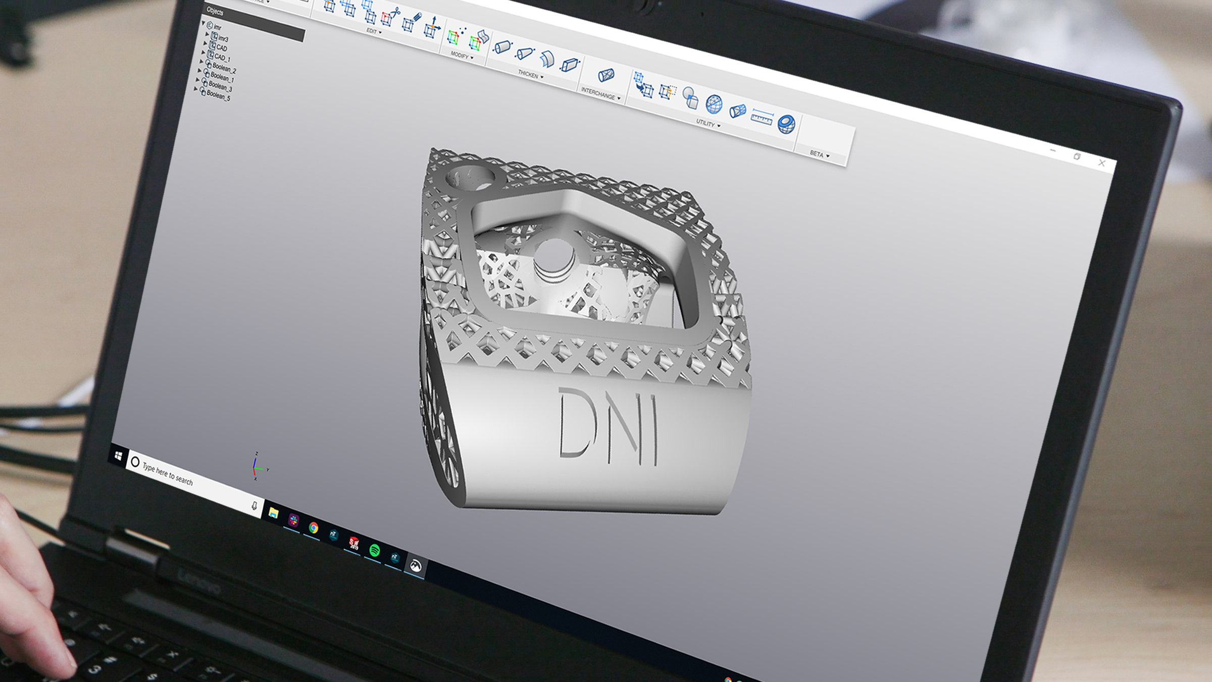

Lattice creation enabled by nTopology Element

Once the design parameters for the implants were decided, IMR produced the design files using nTop Platform. nTopology and Renishaw worked together closely to ensure their products were compatible, so that a design could be seamlessly translated from the nTop Platform to the RenAM 500M.

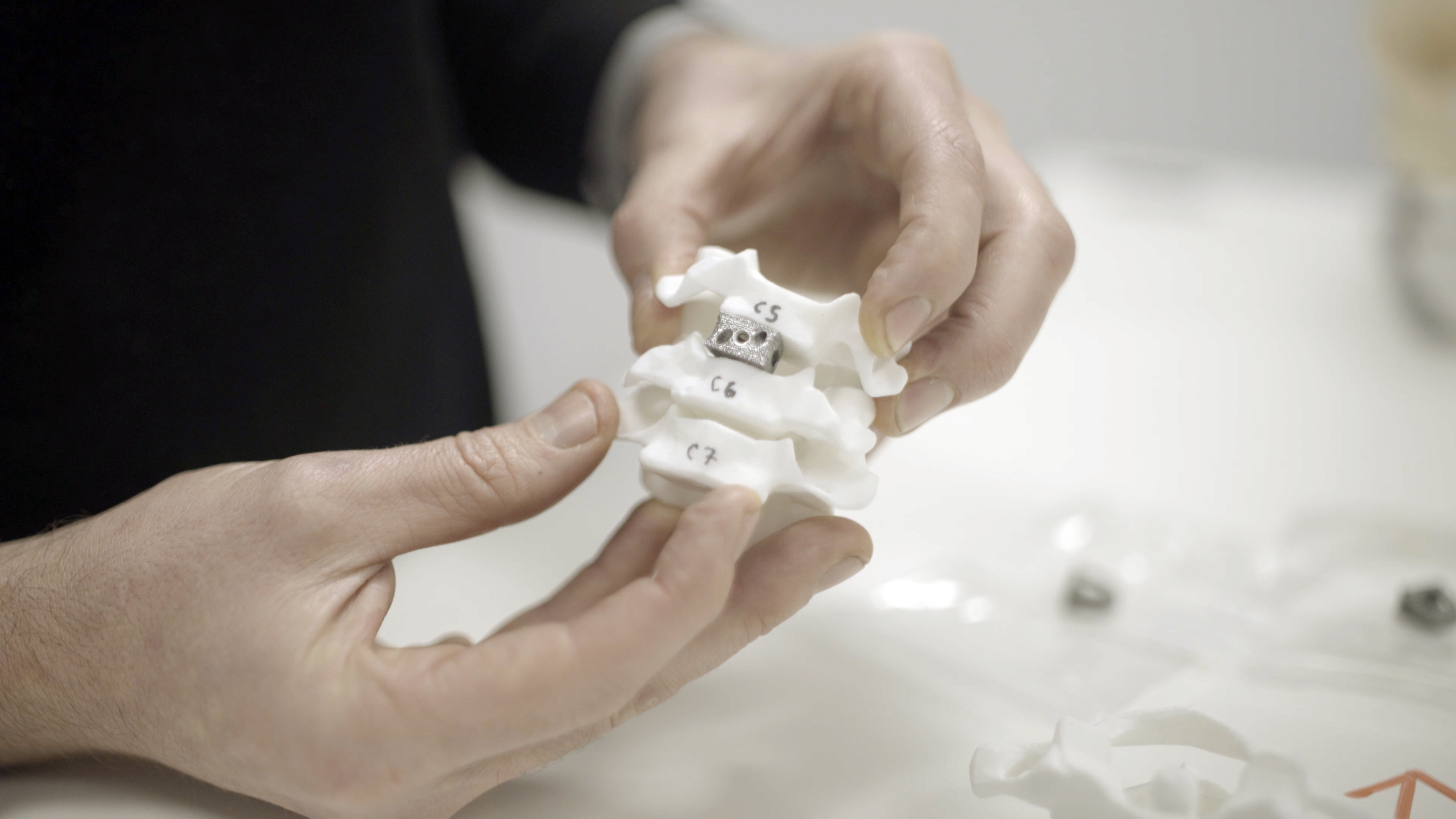

IMR then used the RenAM 500M to produce prototypes from grade 23 titanium (Ti 6Al-4V ELI).
