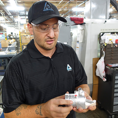

  • R&D Manco - Chris Dupre, CNC milling lead
    Chris Dupre, CNC milling lead, describes the setup stability challenge that initially affected the milling of this hogout part.
