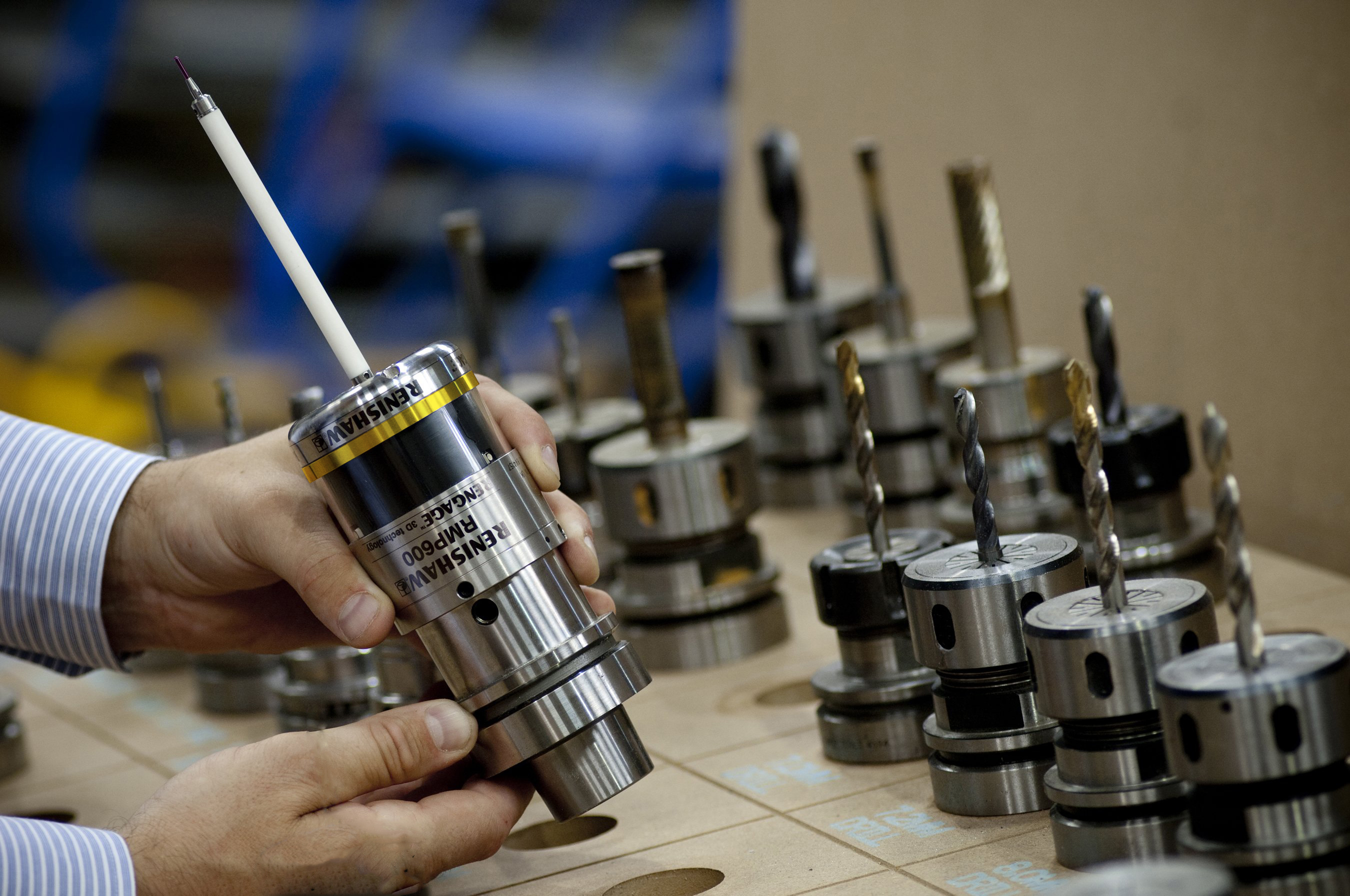

Tods Aerospace: Bob Young, CNC ManagerThe RMP600 is a compact touch probe which incorporates Renishaw’s patented RENGAGE™ high accuracy strain gauge technology and uses proven frequency hopping spread spectrum (FHSS) radio signal transmission.  It offers all the usual benefits of Renishaw touch probes, including the ability to measure complex 3D part geometries on all sizes of machining centres.

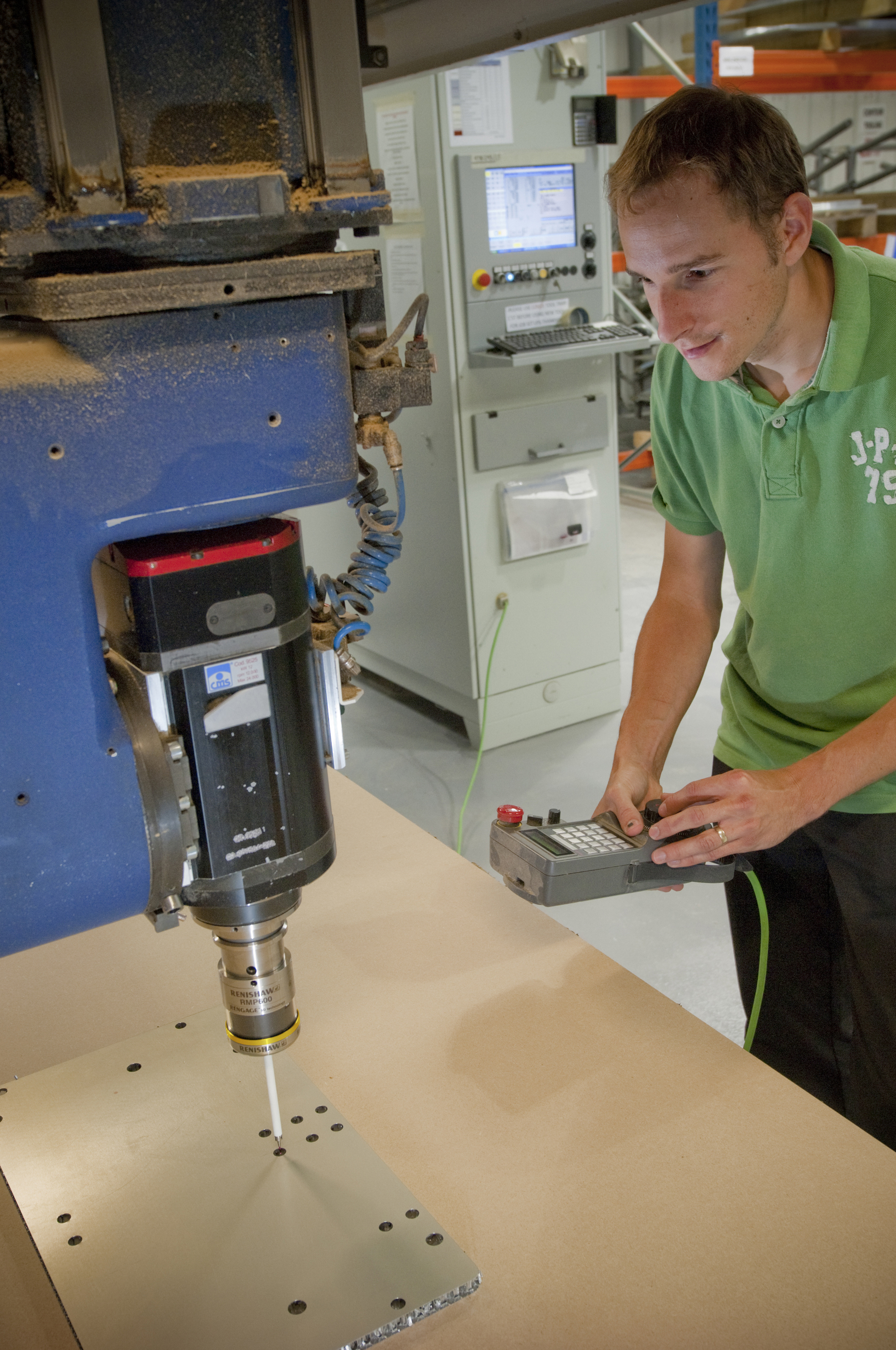

‘One of the key reasons for purchasing the probe was to align the AW159 cabin roof and then machine it,’ says Mr Young. ‘This has proven very successful and we are now producing our own CMM reports generated from the use of the Renishaw OMV software and the RMP600 probe. Without the probe we would not have been able to machine the roof as accurately and we couldn’t have aligned the jigs with such precision.’
Tods now supplies a total of 126 components for the AW159, which will be required at the rate of one set (aircraft) a month.
‘We also use the Renishaw probe for first article inspection (FAI) on every new civil aircraft flooring project,’ adds Mr Young. ‘For example, we currently have a project where a batch of machined components need to go back on the CMS router, as the customer has made a modification. We’ll use the probe to re-align the component prior to machining the additional feature.’
Bob Young also claims that the RMP600 allows the company to take on more complex work and produce parts at the required high quality, faster than ever before. ‘We still feel that we’re in the early stages of getting to know the probe’s capabilities,’ he says, ‘but we are very happy with the accuracy and, in particular, the consequent reduction in scrap parts further down the production line. These are large, expensive components and we can use the probe to identify and avoid errors while we are still at the R&D stage.’

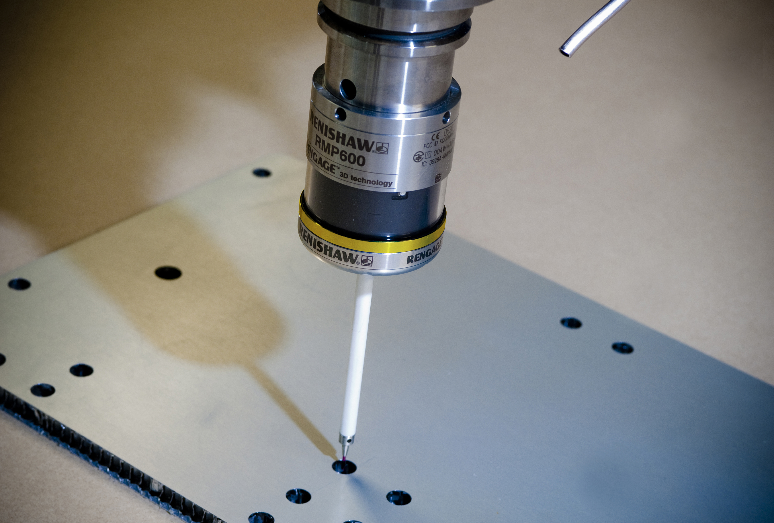

He continues, “When we get a CAD model we take a close look and start working out a plan to machine the tooling,’ says Mr Young. ‘Once we have the first finished part, we’ll write a programme for the Renishaw probe, to check that all of the holes and features meet the specified tolerances.’
The accuracy gains attributable to the RMP600 touch probe are echoed by Tods’ Quality Director Martyn Perks, who states, ‘Digital manufacture & digital design has given different sorts of tolerances and different features which using traditional measuring equipment such as micrometers and vernier calipers doesn’t really get us to the levels of quality and accuracy and checking that we require.’
Tods Aerospace: RMP600 touch probe checking machined holesAccording to Richard Winterbottom, Tods Aerospace was the first company in the country to gain SC21 Bronze recognition for Supply Chain Excellence, awarded in July 2008. ‘We aim to provide solutions in composites, working closely with OEMs to meet new product introduction deadlines, ‘on time and on budget’. We’ve invested heavily in our manufacturing capabilities to achieve the very highest quality, and that investment strategy is paying off.’
