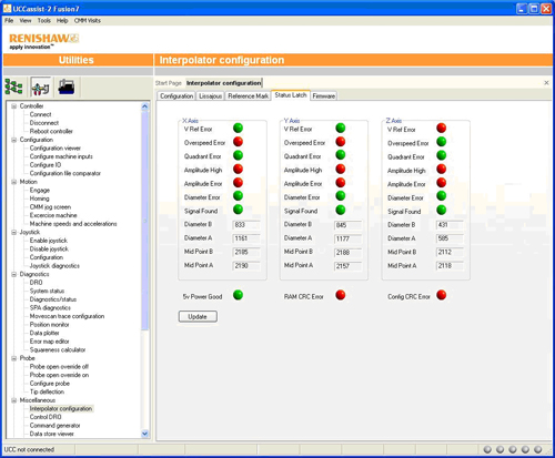

Debug function - Status Latch
Clicking on the 'Status Latch' tab shows the errors latched for all three axes.
status latch tab
Any of the errors shown will cause the UCC to report a readhead error. This tab allows the error to be identified. The latest latched errors can be viewed by clicking the 'Update' button.
ErrorCause
 VrefSignal reference < 1.25V (2.1Vpp  only)
 Over speedPhase and quadrature signals are coming in too fast or too noisy to output digital signals at the set maximum output rate.
 QuadrantPhase and quadrature signals are coming in too fast or too noisy to accurately interpolate.
 Amplitude high
Phase and quadrature signals are coming in too large or too noisy to accurately interpolate.
 AmplitudePhase and quadrature signals are coming in too small or too noisy to accurately interpolate.  This threshold can be set in Advanced settings.
 Diameter The calculated diameter of the Lissajous is too small to accurately interpolate. This threshold can be set in Advanced settings.
 Signal found The Interpolator hasn’t found two complete Lissajous signals and will not calculate diameter and centre of the signals.  The CMM may not have moved since power up.
 5V Good Incorrect Voltage present on PCB.
 Ram CRC On board look up tables corrupted.  Unit will need the firmware re-flashed by Renishaw personnel.
 Config CRC No valid interpolator configuration set.

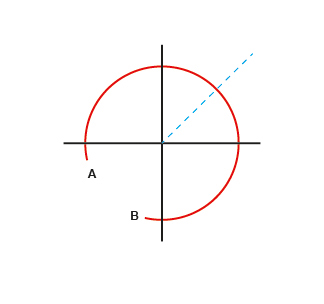

The Lissajous figure can indicate the start/stop points of the reference mark to allow optimum adjustment.  Select this option by clicking on ‘Trigger On Reference’.  This may require the CMM to be repeatedly run over the reference mark to build up the data points
Ideal Reference Mark Lissajous
Using the reference mark trace on the lissajous, the reference mark pick up magnet can be physically adjusted so that the beginning and end points (A and B) are opposite the 45 degress (dotted line) of the lissajous as shown.
