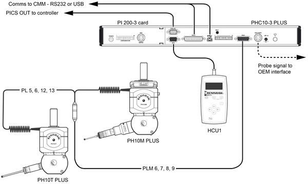

This section describes a number of PH10 system interconnection and recommended interconnection cables
PH10 with  two-wire TTPs
1Communication connection to CMM controller - RS232 or USB
2Raw probe signal to OEM interface

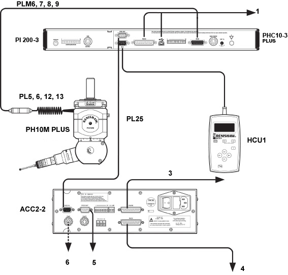

PH10 2 wire TTPs with autochange
KeyDescription
 1 Communication connection to CMM controller RS232 or USB
 3 Communication to CMM controller
 4 Communication to autochange rack
 5 PICS output to CMM controller
 6 Probe output to CMM controller
