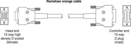

REVO single orange cable connections
It is now possible to cable REVO using a single orange cable rather than the standard system of two grey cables.
Wiring instructions
Head end
(15 way high density D socket)
Pin number
 Colour
 Controller end
(15 way D plug)
Pin Number
1
 Orange
 3
2
 Black
 2
3
 Red
6
4
Grey
7
5
Brown
15
6
Orange/black
11
7
White
4
8
Clear
12
 9
 Inner screen
 9
10
Pink
8
 11
 Green
 1
 12
 Green/black
 10
 13
 Blue
 5
 14
 Violet
 13
 15
 Yellow
 14
 Shell
 Screen
 Shell
REVO orange cable
You will also need to order A-3060-0045 kit which contains the Y cables for both the REVO and UCC controller.
