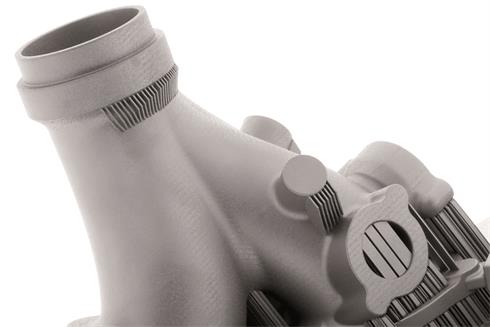

The item we are talking about is an exhaust manifold for F1 engines used for racing by Scuderia Ferrari. This is a continuously evolving part which is replaced after every race to benefit fully from all the advantages of research and also to minimise the risk of breakage. This component is subjected to both significant thermal and mechanical stresses and it comes into contact with extremely aggressive exhaust gases: this is why it is made of Inconel, a nickel-based alloy which proves extremely resistant to corrosion and high temperatures.
However, this is a relatively heavy material and difficult to machine owing to the removal of the swarf: the decision to use additive manufacturing made it possible to make a part that is on the whole extremely sturdy and light-weight thanks to the very limited thickness of the walls, something which would have been extremely difficult to achieve through mechanical machining. The need to produce pipes of the required thickness with the correct fluid dynamic shape and to incorporate auxiliary shapes, such as insertion points for sensors, would have made machining even more complex using traditional technology.
The only solution, aside from additive manufacturing, was casting, which, however, entailed considerably longer manufacturing times and near-zero flexibility, in the sense of the ability to adapt to research developments. In addition to development, even the ‘normal' routine needs different parts depending on the characteristics of the track on which the race is to be held: that means different moulds for different requirements and no possibility of change except with the creation of new moulds. Product development and the pursuit of improved performance lead to the conception of new solutions, which translate into changes in shape, with modifications (more or less evident) that still lead to different manufactured products which need to be produced and tested with a very quick turnaround time. The only technology capable of quickly producing finished parts from mathematical figures which differ each time is additive manufacturing: the only choice considering all these factors.
So in actual fact, additive manufacturing is not an alternative technology to mechanical machining, but rather an evolution of casting: complex parts can be produced without the need for moulds and without having to take into account the limitations of the passage of the molten mass due to its temperature and viscosity. Additive manufacturing and swarf removal machining are therefore complementary technologies, since the part produced using additive manufacturing subsequently needs to be machine-processed to achieve levels of finish and flatness that could not be obtained in any other way. This ‘complementarity' is particularly evident in this part where, in addition to the insertion of sensors mentioned earlier, grip points were incorporated into the part specifically to facilitate subsequent machining. Considering the shape of the part with very thin walls, the difficulty of machining the material and the need for absolute precision, this was the right solution for the subsequent finishing phases.
Essentially this part constitutes a concentration of all the aspects of a DfAM (Design for Additive Manufacturing), which includes the design of the main function of the part (optimising the flow of high temperature exhaust gases), of the auxiliary function (insertion of sensors) and of the process, such as the creation of grip points and references for subsequent mechanical machining.
A project that starts after the design
As we've seen, this is a complex part owing both to its conditions of use, to the material, and also to its particular design. In the case of Scuderia Ferrari, the design of the part is the sole responsibility of the team, which provides the maths, but how does one tackle all the issues linked to actual manufacturing?

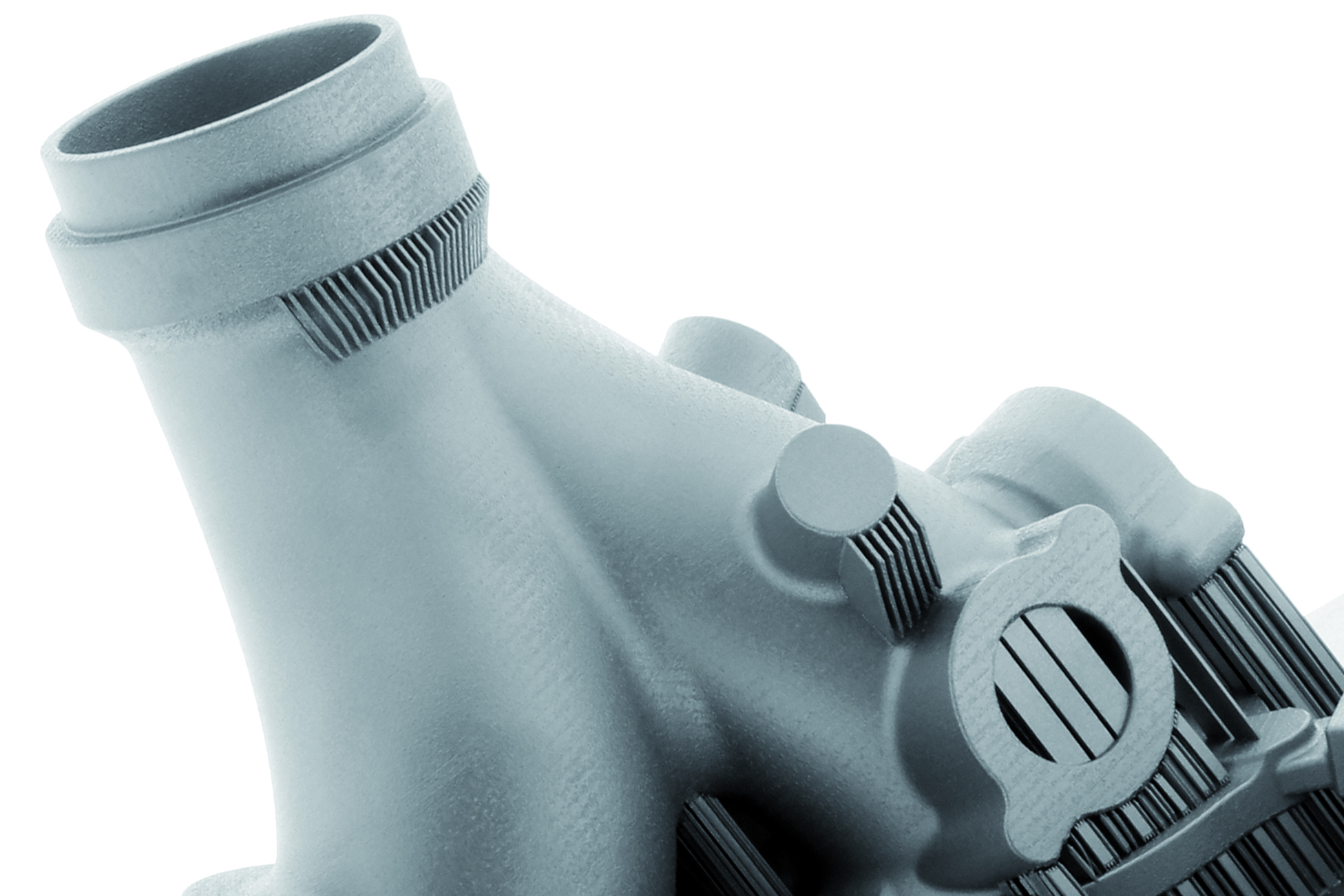

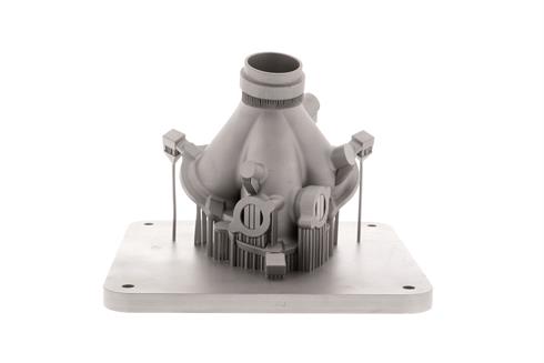

The most significant steps were definitely the definition of the positioning of the part in the car, and the engineering of the related supports: indeed, a profound knowledge of the additive manufacturing process was required to achieve these steps. An additional challenge lay in the fact that the supports were under no circumstances to be fitted inside the gas passageways to avoid compromising the fluid dynamics.
Optimising the supports is extremely important because all the powder used to make the supports cannot be recovered and this affects the processing time in the machine as well as the amount of time it takes to remove it at the end of the task. At the same time, the supports have a very important function, which is to guarantee the geometric stability and define a path for the melt heat disposal.
To achieve this, supporting structures were made to allow a reduced quantity of traditional supports to obtain the savings we discussed earlier. The supports made are very thin and, if they are very long, there may be a risk of distortions; what's more, they are often melted with parameters that make them less ‘dense' than the main part so as to allow simpler removal later, while retaining their function. The supporting structure on the other hand has a more significant cross-section and it is molten with the same parameters as the part in order to achieve a significantly higher robustness.
The advantages of this choice were many: the correct direction of the part and the use of these supporting structures made it possible to reduce the length and quantity of the supports, with the ensuing reduction in processing time. Based on what we have seen so far, it is necessary to specify that every part modification devised by the Scuderia Ferrari team makes it necessary to reassess the entire car-positioning project to optimise the situation depending on the modifications made. At this stage, intervention may be necessary to various extents, which essentially ‘adapt' what has already been made to the new design or, also, start from scratch with the positioning and the creation of the related supports and supporting structures. In any case, intervention is always required, with the modification, the addition or removal of supports, and this is irrespective of the extent of the part modification.
