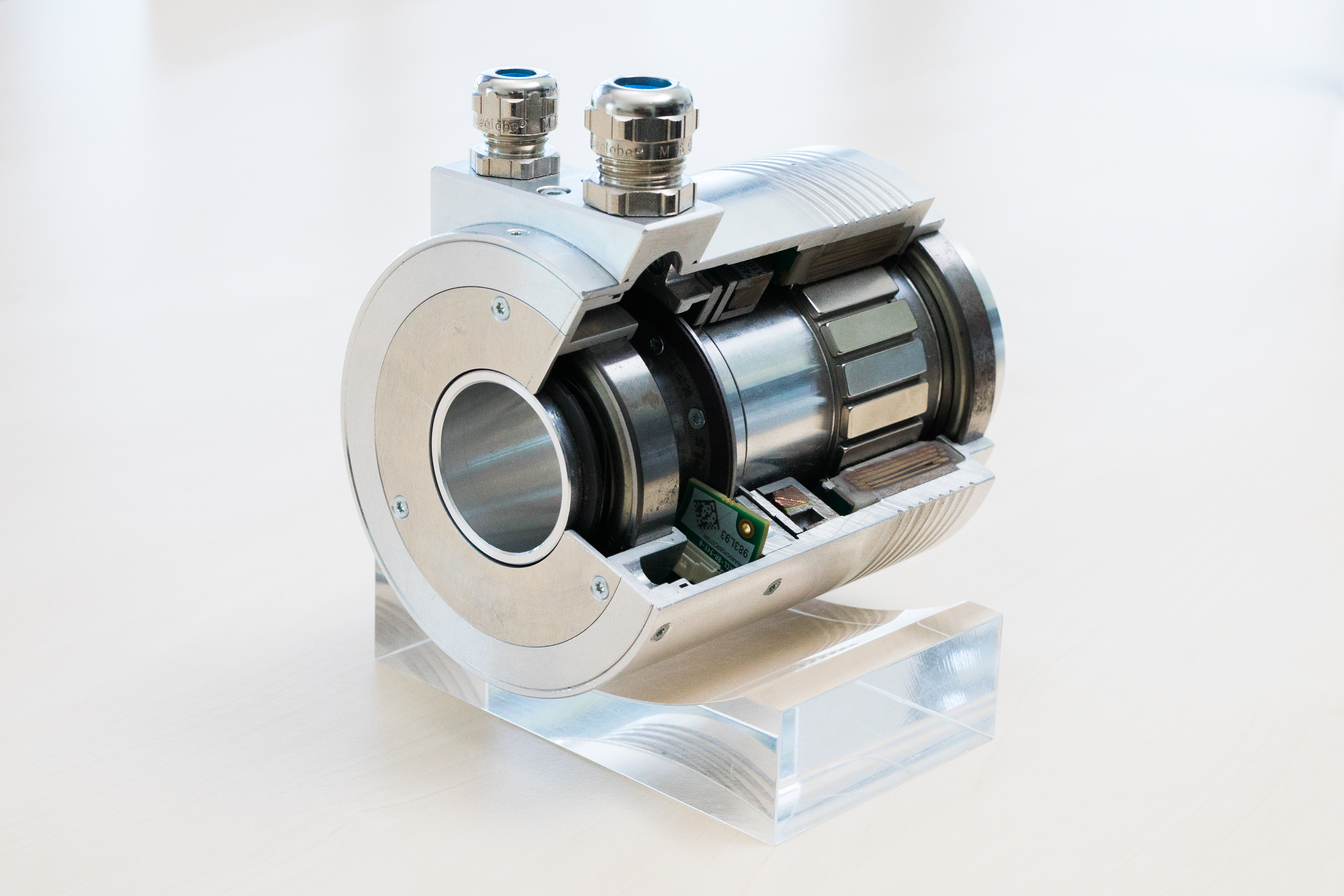

TQ-RoboDrive motors consist of several main components: the stator and rotor, a safety brake, and an encoder — all mounted in a compact motor housing. The encoder sits at the rear of the motor and each component has a different diameter.
The sequence of assembly is important as there is a stray magnetic field emanating from the safety brake, which requires that the encoder be positioned behind the brake to shield the encoder ring.
“In the end, they were able to design a sensor that fits our ILM 25 and ILM38 sizes perfectly, giving us a complete drive solution for both the hollow shaft framed motors and the frameless servo kits. They did a fantastic job”, concludes Mr Kerber.

Cut-away of a TQ-RoboDrive hollow-shaft servomotor with an AksIM™ magnetic absolute encoder.
