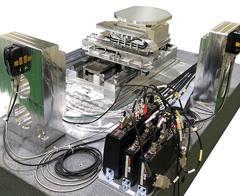

Vacuum stage, for semiconductor wafer inspection (AOI), fitted with RLE laser encoder system
Vacuum stage for semiconductor process application

For nanometre-level precision, VAD employs Renishaw's RLE laser encoder system for the position feedback control of an XY stage designed for semiconductor mask inspection by extreme ultra-violet light. The RLE system uses plane mirrors that are mounted on each linear axis and is suitable for vacuum applications, because the laser head can be mounted outside the vacuum chamber.
Mr Song continues: "Renishaw provides us with cost-effective and high performance position feedback solutions and offers excellent technical support and regular training. The RLE laser encoder delivers nanometre accuracy for our front-end semiconductor process equipment with the additional benefits of easy installation and setup, and short lead times."

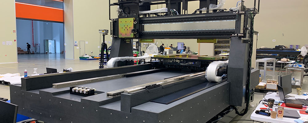

Stage for automatic optical inspection (AOI) of flat panel displays (FPD)
