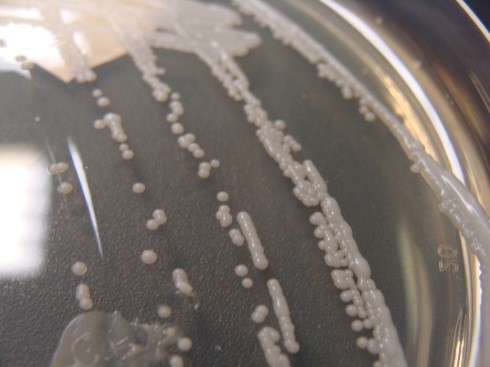

Bacterial Colonies
Image: Colonies of Staphylococci
