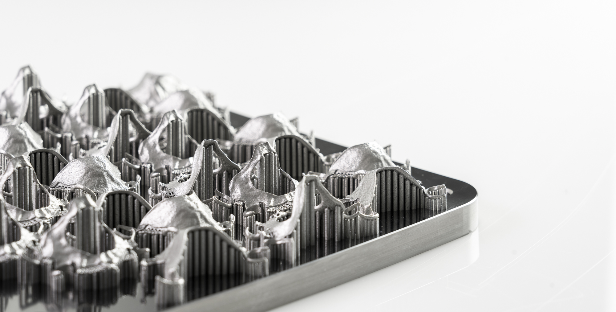

Dental RPD build plate banner
[2000 x 1012]
[755kB]
