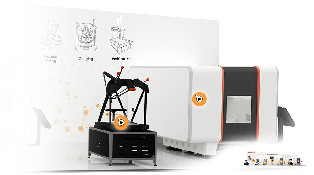

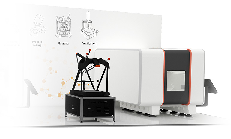

Renishaw's Equator™ 500 – versatile shopfloor gauging and intelligent process control for larger parts
The larger Equator 500 system enables the gauging of larger parts, with a working volume of 500 mm in diameter and up to 400 mm in height.
Both Equator 300 and 500 comparator gauging systems are accurate between a range of 5 ºC and 50 ºC at any rate of temperature change, and are capable of scanning speeds in excess of 200 mm/s.
Every system is compatible with simple-to-use Organiser operator software, EZ-IO software for automation, and IPC (intelligent process control) software for updating tool offsets on CNC machine tools.

Automatic update of tool offsets directly from Equator 300 and 500 comparator systems
The Equator comparator range is compatible with new IPC software which allows constant monitoring and automatic adjustment of a machining operation, keeping part dimensions close to nominal and well within process control limits. This correction of process drift improves part quality and manufacturing capability, and reduces scrap. The proximity of the Equator comparator gauge to the CNC process allows adjustment at the point of manufacture, avoiding time delays or reliance on finished part (tailgate) inspection. An Equator comparator gauging system can be connected to one or multiple CNC machine tool controllers.
