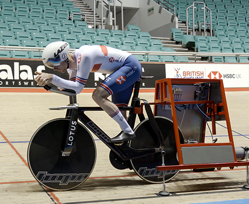

Ed Clancy OBE, Triple Olympic Gold Medallist, discusses the HB.T bike with designers from the Great Britain Cycling Team

  • Ed Clancy OBE, Triple Olympic Gold Medallist, testing the HB.T bike

  • Ed Clancy OBE, Triple Olympic Gold Medallist, testing the HB.T bike at the Manchester Velodrome, UK

“Your bike just becomes an extension of your body, and you get used to how it feels and how it sounds. It's unusual that you get on a completely different bike and straight away it feels better,” commented Ed Clancy OBE, Triple Olympic Cycling Gold Medalist.
