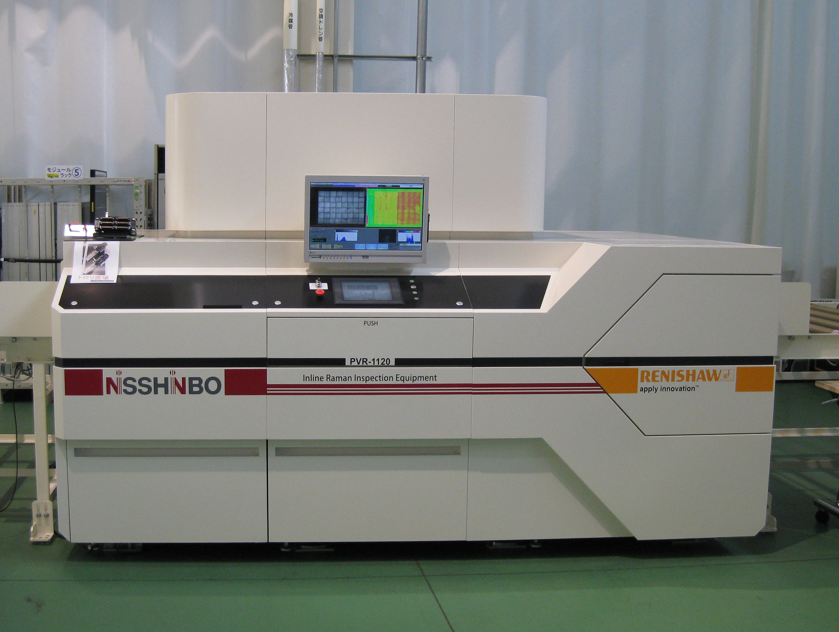

Online systems
Renishaw has provided numerous custom Raman systems for online quality control purposes.
