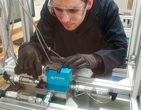

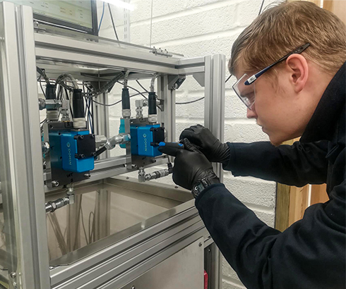

Domin’s direct drive valve
Domin's direct drive valve
