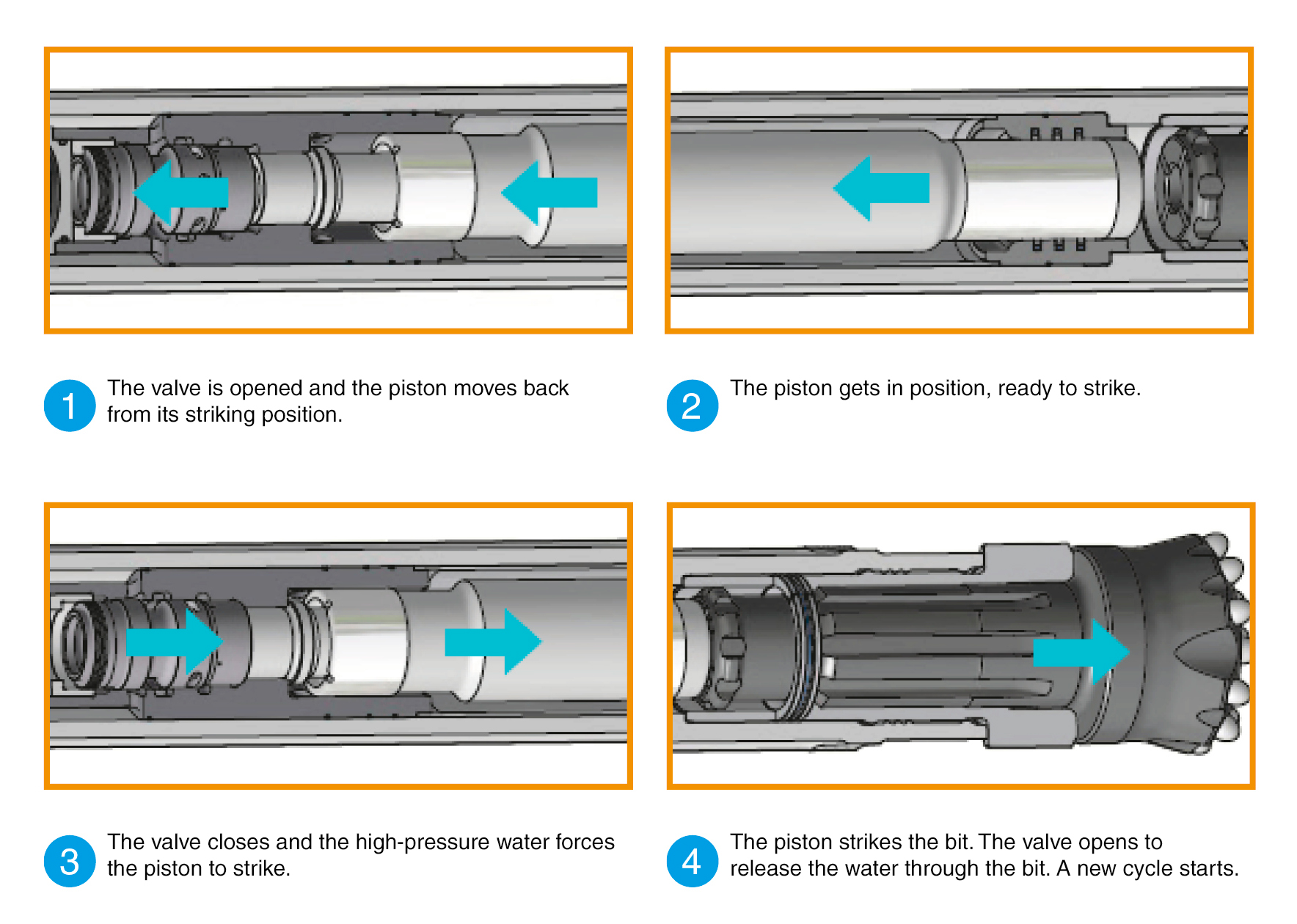

Wassara is a Sweden-based mining company with a number of innovative products capable of extracting minerals with minimum environmental impact. Wassara's technology uses high pressure water to power the Down-The-Hole (DTH) hammer. Wassara's water-powered DTH hammer is the most environmentally friendly percussion drilling method existing today. The DTH hammer is powered by water, and no oil is used for lubrication, meaning no contamination of air or water. The water is effectively suppressing dust as well. The incompressibility of water is a key factor in the function of the Wassara hammer system. It also gives a major energy cost saving compared to the more traditional air DTH technology, and reduces the energy demand to power the hammer.
Water is the chosen medium since it allows for a high frequency and high energy impact per blow. In addition, when the water leaves the hammer it has a sufficient velocity to also bring the cuttings and debris to the surface and clean the hole. This technology offers superior benefits, such as high productivity, borehole quality and minimum collateral impact on the formation that is being drilled. The water-powered DTH hammer technology gives mining companies the ability to choose mining methods most suitable for the ore bodies, and is viewed as a big step towards optimised mining.
Schematic diagram of the down the hole (DTH)
Above: Schematic diagram of the down the hole (DTH) hammer technology

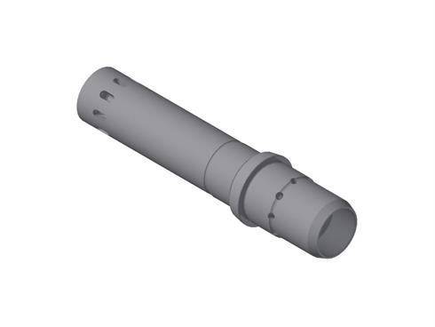

There are many complex parts that make up each DTH tool. At the heart of the tool is the sliding case that provides the bi-directional flow of water for the piston assembly. The sliding case requires several internal fluid channels to allow the flow of water, and due to its complexity, it cannot be fabricated from one single part. This complexity in the design makes these parts relatively expensive. Adding to the costs are frequent rejects in production as a result of the joining process, as well as failure due to wear or pitting corrosion increasing the maintenance requirements.

In an attempt to reduce the cost, and increase reliability of the sliding case component, Wassara approached Renishaw to investigate whether additive manufacturing (AM) could be a suitable alternative manufacturing method. One of the well-known benefits of metal AM is the ability to combine two or more complex machined parts into a single 3D geometry, or to simplify complex fabrication steps such as drilling cross-holes that require one end to be blind plugged or welded. When the resulting part can be made without any further design modifications this provides an ideal basis for testing the validity of using metal AM parts within the same application. Hence, it is possible to compare like for like parts under standard test conditions, and any significant differences in the results can be directly attributed to the change in production technique. Wassara's sliding case geometry was redesigned to incorporate some of the benefits of AM design freedom.

Wassara case study - Representation of the re-designed for AM sliding case component
