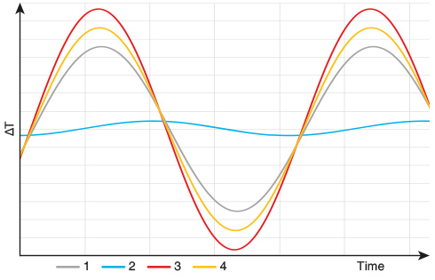

A fibre laser cutting machine is used to cut, using the same cutting path, a series of plate steel blanks (2 m x 2 m x 2 mm) arranged in rows along the machine's longitudinal axis. Air temperature fluctuations make direct temperature compensation challenging, particularly for a 20 m axis, as shown in Figure 2. In this case, the machine's longitudinal and gantry axes have significant thermal mass and maintain a near constant average temperature, and therefore size, throughout the cutting process.
An enhanced metrology solution would be to use a linear encoder with a substrate-mastered scale for motion control in the plane of the machine bed, along both the X and Y axes. Thermal expansion of the encoder scale and the machine axis would then be closely matched, which removes the need for active compensation of the scale. Laser position accuracy is further improved because scale disturbance is not significant for this system.
The effect of long-term air temperature changes on the workpiece could be compensated by machining a calibration part at regular intervals to provide a coarse offset correction. This correction remains valid for a long time due to the high thermal mass of the machine substrate which maintains a relatively constant average temperature and ensures dimensional stability of the scale throughout the cutting process.
Figure 2: Temperature of an encoder scale (1) mounted on a large machine axis compared with the bulk temperature of the machine axis (2), a fluctuating ambient air temperature (3) and the measured (e.g. with a thermocouple) scale temperature (4).
