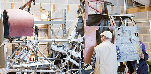

Only 3,317 Typhoons were ever made and there are very few around today; none are in flying condition. In 1998, when an almost complete — but exceedingly corroded — cockpit section was found at a scrap yard in Wiltshire, volunteers vowed to restore an aircraft with a rich national and regional importance.
Located just down the road from the birthplace of the Typhoon in Gloucester, the Jet Age Museum is pushing forward with the project today. After hearing about Renishaw's additive manufacturing capabilities, the museum wrote a letter to Sir David McMurtry, Chairman and Chief Executive of the global engineering company. In the letter, the Jet Age Museum asked for Renishaw's help recreating two extremely rare and unconventional brackets for the Hawker Typhoon's fuselage. The Museum was not disappointed with the response.

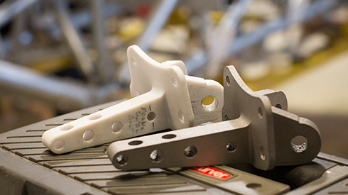

Renishaw used the original drawings and additional measurements to create a 3D digital model of the Typhoon bracket using Siemens NX 7.5 CAD software. This allowed the company to conduct parametric and direct surface modelling to produce digital replicas of the parts.
Once Renishaw completed the digital modelling stage, the engineers 3D printed prototype parts in plastic polycarbonate. Renishaw then delivered these to the Jet Age Museum's workshop and fitted them to the cockpit to make sure they were the right specification. When engineers confirmed the parts were accurate, Renishaw proceeded to additively manufacture the final builds in metal.
The Gloucester Aircraft Company originally made Typhoon cockpit brackets in aluminium. This is because of the metal's physical properties; low density — and therefore low weight — high strength and malleability. Renishaw occasionally uses plastic to additively manufacture prototype parts, before producing the final build in a specified metal with the desired properties for the application.
Renishaw produced the metal brackets from aluminium powder in four separate builds using one of its AM250 additive manufacturing machines; the parts were then surface finished using a mixture of bead blasting and hand finishing techniques.
