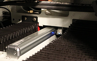

FORTiS™ enclosed encoder inside TGT's tool grinding machineFORTiS™ enclosed encoder inside TGT's tool grinding machine
