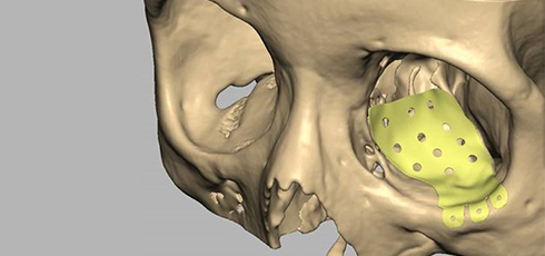

Mustafa worked with Peter Evans and Heather Goodrum at Morriston Hospital's Maxillofacial Prosthetics Laboratory in Swansea to design the implant in computer-aided design (CAD), with the plates to be visualised and edited in a 3D virtual environment using a haptic arm.
Designing the orbital floor
Mustafa suggested clinical design modifications, using the flexibility of the process to compensate for the defects from Rai's first operation, where scar tissue and an ill-fitting bone graft could potentially undermine the plate's chances of a good fit.
The plate needed to cover the existing orbital floor and medial wall defects. The team also made adjustments on screen to increase the venting holes, thus aiding drainage. They reduced the extension to the rear of the plate to avoid the optic nerve and reduced the extension of the plate up the medial wall to make surgical placement easier and more predictable.
The earlier fracture had allowed some orbital fat to herniate down in to the maxillary sinus resulting in a sunken eye appearance. To compensate, an exaggerated curvature was added to the plate to recreate the retrobulbar bulge of the eye socket and give added aesthetic benefit.

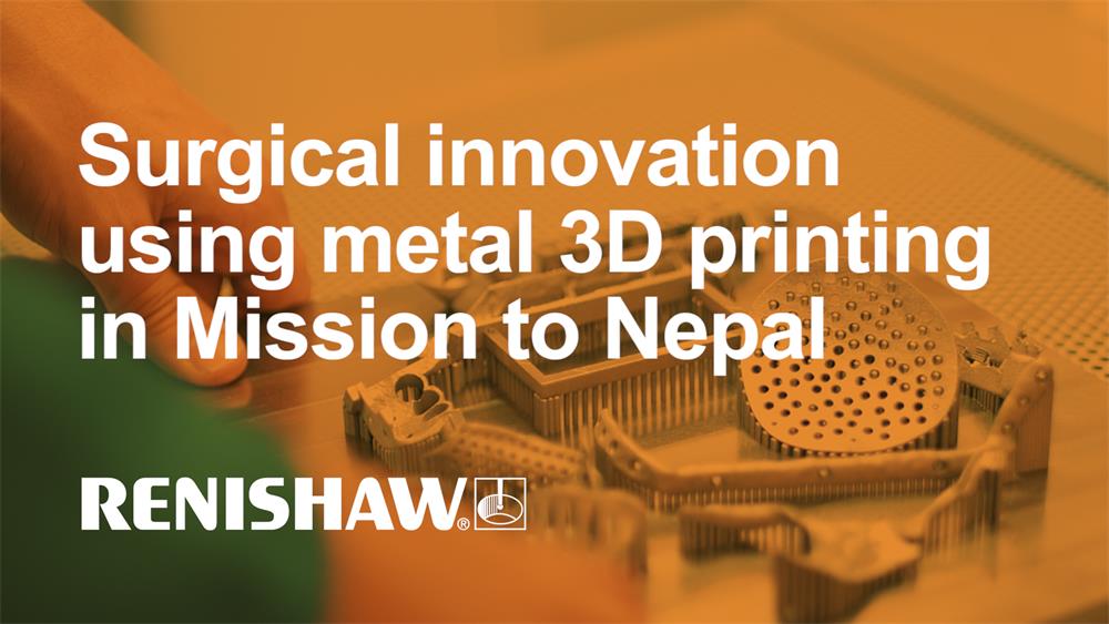

The .stl files were sent to Renishaw's new state-of-the-art additive manufacturing facility in nearby Miskin, where an implant was produced on Renishaw's AM250 machines. Renishaw's digital workflow ensured the company was able to deliver the implant printed in the proven titanium Ti MG1 material which is tested to ISO 10993 part 1.
Only one implant was needed, but a second implant was manufactured using traditional techniques at the Maxillofacial Unit, Morriston Hospital as a form of insurance, given the scale of the journey and the volatility of the region after the earthquakes.

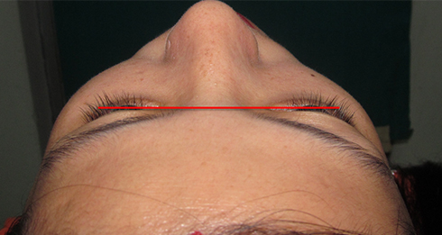

Shashi after Nepal mission
The operation took twice as long as it would have taken in the UK, due to local conditions. There were four clinicians in the operating theatre and the procedure was watched by Nepalese and UK trainee surgeons, who assisted and observed for training purposes.
By the time Mustafa left Nepal, Rai was still slightly swollen from her operation, but once the sutures were removed, she had normal visual acuity, no double vision, good eye and eyelid movement and the correct eye position had been restored. She made a full recovery and was delighted with the results.
