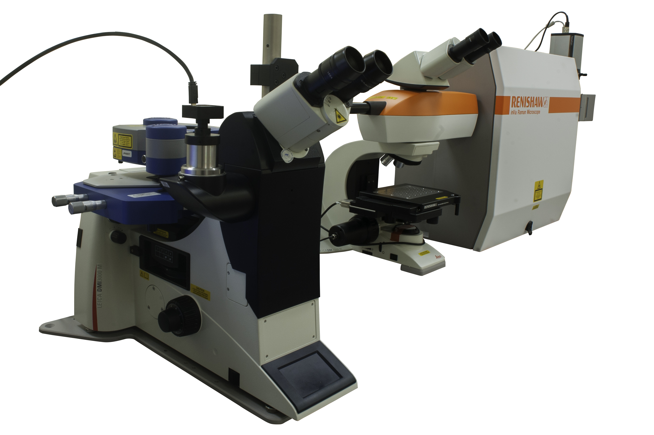

You can combine the power of inVia with scanning probe microscopes (SPMs and AFMs) to investigate the composition, structure and properties of materials at nanometre scales.
Choose the best system
The inVia is incredibly flexible; Renishaw can directly couple it to a wide range of AFMs and SPMs from vendors such as:

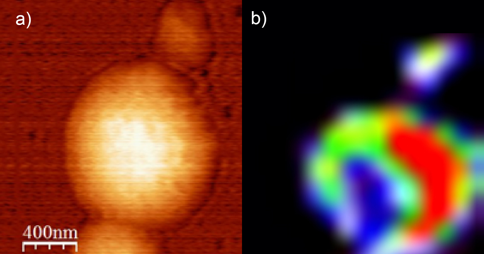

TERS: tip-enhanced Raman scattering
Selected inVia-AFM systems can perform tip enhanced Raman scattering (TERS). This exciting technique uses a sharp plasmonic tip to obtain chemical information at the nanometre scale.
TERS mapping complements StreamLine™ and StreamHR™, giving you the flexibility to study your samples at whichever resolution you like.

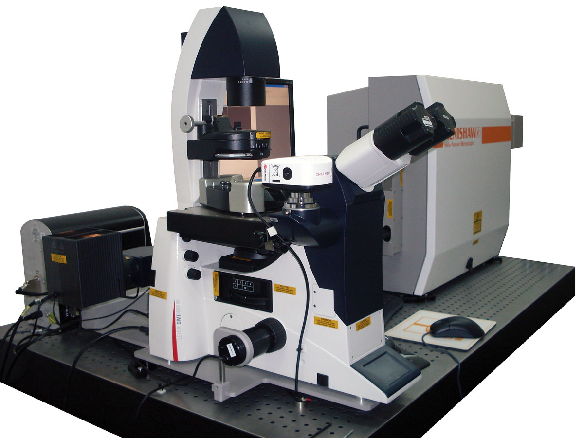

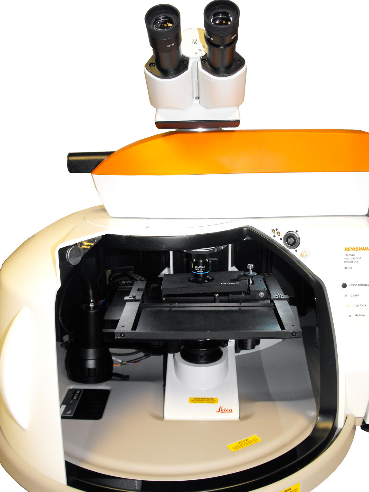

Renishaw's specially designed flexible coupling arm can be used to optically integrate inVia to SPM/AFMs. It uses mirrors to direct the light, providing a higher efficiency than fibre optic coupling. You can get your spectra faster, and with higher signal-to-noise.
Alignment is easy. All combined systems offer an inbuilt video with white light illumination so you can clearly see both the probe tip and the Raman laser spot together—critical for TERS work.

You can have confidence in your data. You can simultaneously acquire Raman and AFM data from the same point on the sample without having to move it. This ensures that your data are consistent, even if your sample is changing with time.
