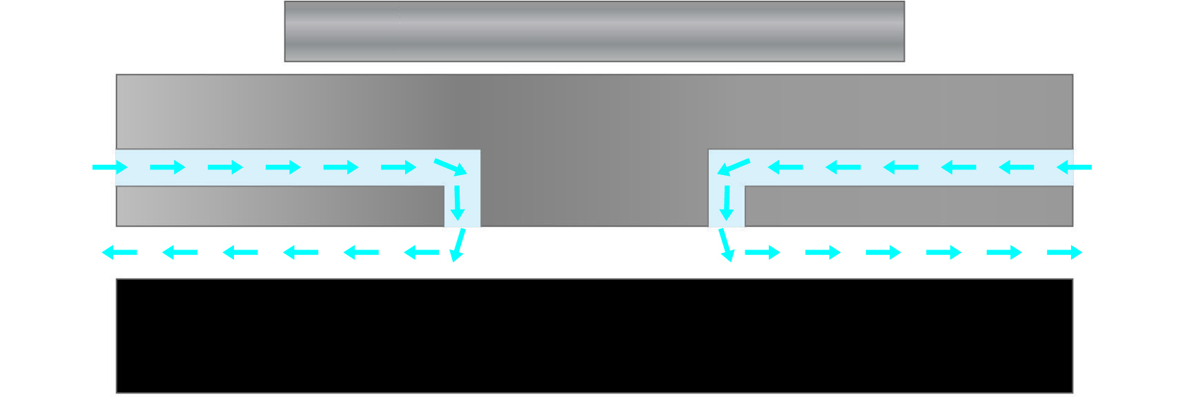

Air bearings in the market can generally be divided into two types: static pressure and dynamic pressure. Static pressure air bearings are commonly used in motion stages. The working principle is to inject compressed air (or other gases such as nitrogen, argon, or carbon dioxide) from the outside. The air passes through a throttle and enters the air gap between the slider bottom and the guide rails of the granite base.
TOYO air bearing stage
Structure of TOYO's air bearing stage
A static pressure air film is formed in the gap that supports the load and suspends the slider over the guide rails. The thickness of the air film (working air gap) depends on the stage design and the surface finish accuracy of the motion pair, generally around 5 to 10 µm.

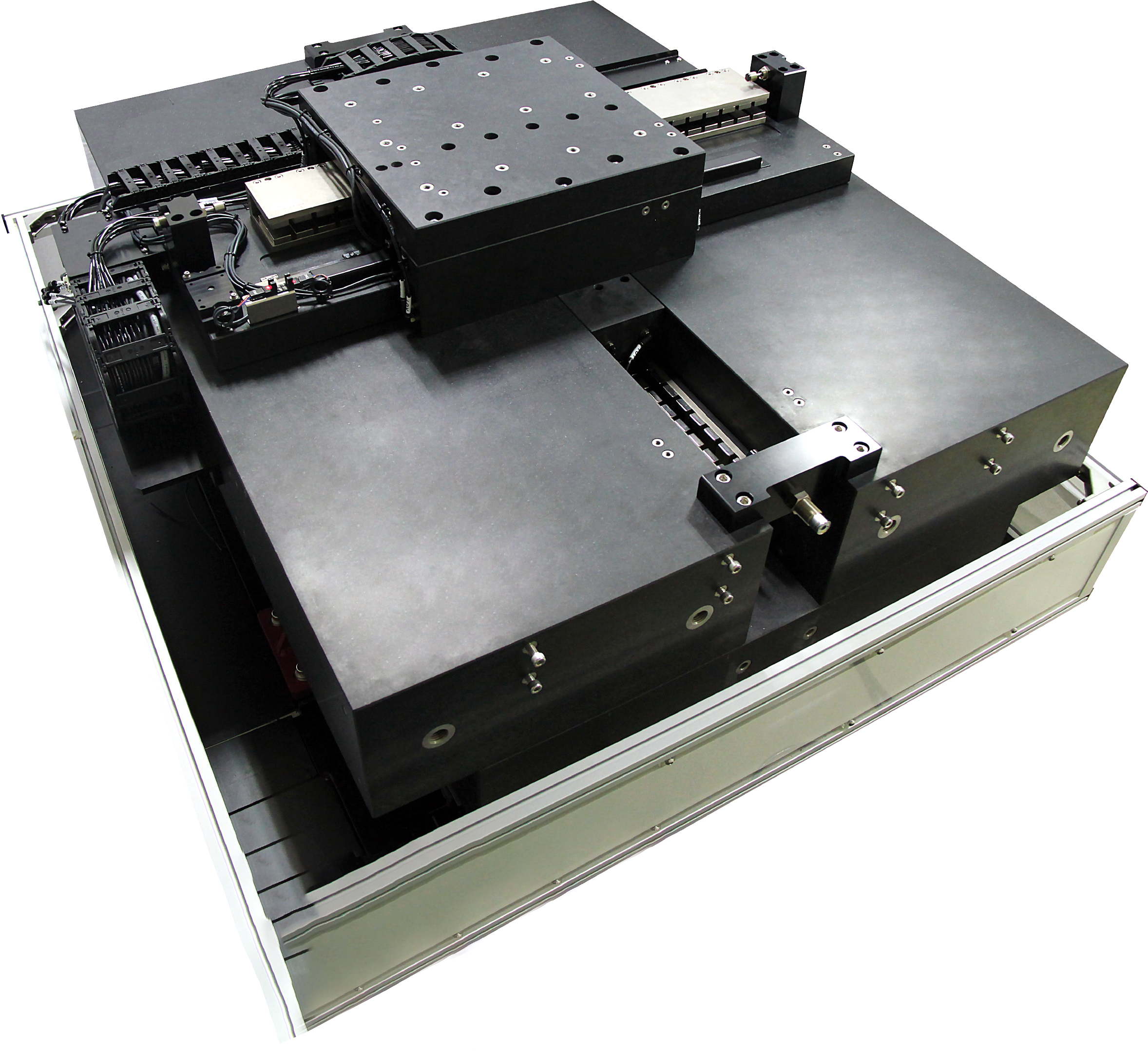

According to Mr. Deng Gui Dun, Vice President of TOYO, the throttle component designed by TOYO is directly embedded in the granite structure inside the air bearing stage, which is structurally simpler, easy to assemble, has high rigidity and good load-carrying capacity, unlike the typical air bearing stages that have an external throttle body.
TOYO's air bearing stages offer a repeatability of 0.3 μm (per 300 mm stroke), providing high accuracy in six degrees of freedom. The XY stage adopts a co-planar structure design, sharing the same reference plane, to solve the problem of error accumulation caused by designs that stack the X and Y axes in the horizontal and vertical planes.
The acceleration of some stage models can reach up to 10 g which is sufficient to meet most high-end application requirements, including semiconductor, flat panel display, PCB, laser exposure and automated optical inspection (AOI) equipment— with AOI applications accounting for the largest proportion. Since AOI needs to scan and image the object under inspection, it requires stable velocity control.

TOYO air bearing motion stage
Linear XY air bearing stage
