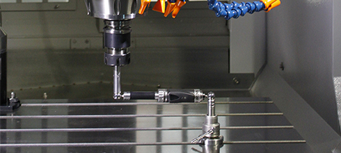

‘Working with a sculptor's precision' is a fundamental part of Jingdiao's corporate DNA, so product quality has always been the first order of business. The company has put this philosophy into practice by procuring the most advanced measurement and testing equipment and instrumentation to ensure product quality, even in the early stages of Jingdiao's development when funds were limited. This arsenal of advanced equipment and instrumentation includes Renishaw's laser interferometers and ballbars, which are used to assess the precision of machining centres. Using world-leading machinery calibration equipment like the XL-80 laser interferometer and QC20-W telescoping ballbar has enabled Jingdiao to maintain strict control over product quality. Moreover, both laser interferometers and ballbars are equipped with a variety of dynamic testing features and fault analysis functions, which provide a wealth of invaluable data for use in new product R&D and the improvement of manufacturing processes for existing products.
