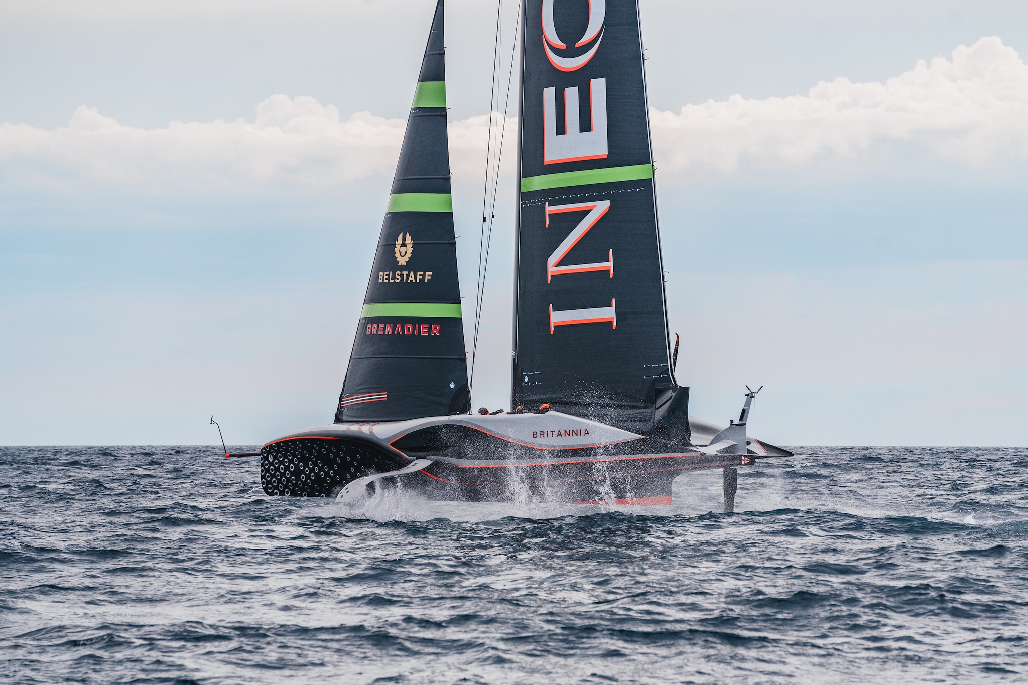

INEOS Britannia - sailing towards a sustainable future with AM
Renishaw, the global engineering company, is an official technical partner of the British sailing team, INEOS Britannia, which is the Challenger of Record for the 37th America's Cup.
Led by former Olympic champion Sir Ben Ainslie, the team will attempt to become the first British yacht to win the America's Cup in its 173-year history. The competition takes place in Barcelona, Spain, between August and October 2024.
Renishaw has supported the British challenger for the America's Cup since 2016. For the current campaign, Renishaw supplies INEOS Britannia with magnetic encoder solutions and additively manufactured parts, plus expertise in position measurement and Raman spectroscopy.

Carbon fibre is commonly used in sailing due to its exceptional strength-to-weight ratio; INEOS Britannia has manufactured both the hull and sails of the race boat Britannia from carbon fibre.
INEOS Britannia has reduced its consumption of new carbon fibre by incorporating recycled carbon from the British-based recovery plant, GEN2 Carbon Fibre. This material has been used to make hull and deck moulds. The team has also partnered with Ocean Republic to give a second life to its carbon fibre sails. By repurposing the sails, approximately 17 tonnes of CO2e are saved. This commitment to circularity ensures that no carbon fibre ends up in landfill after use.
