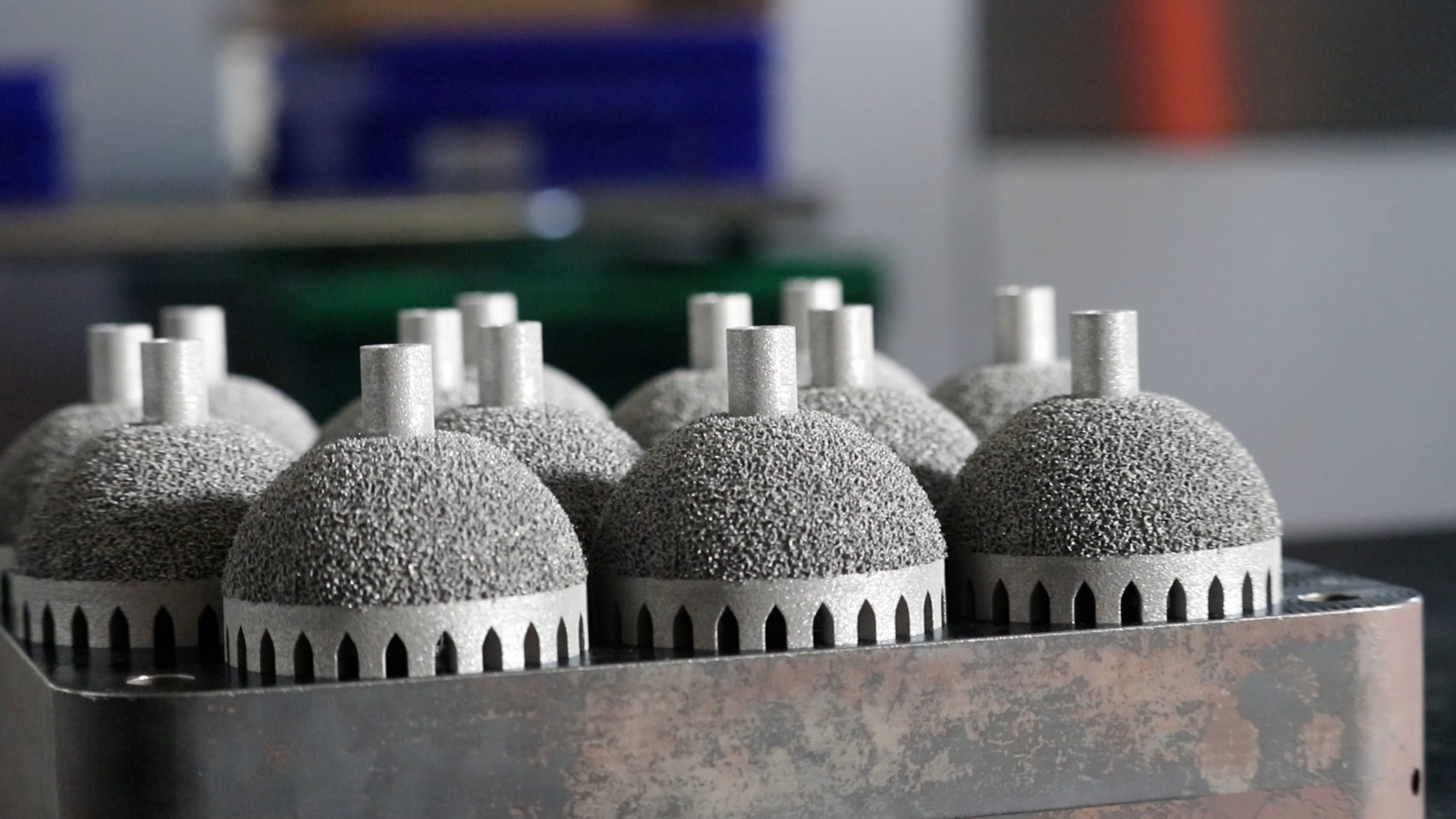

Additively manufactured medical components

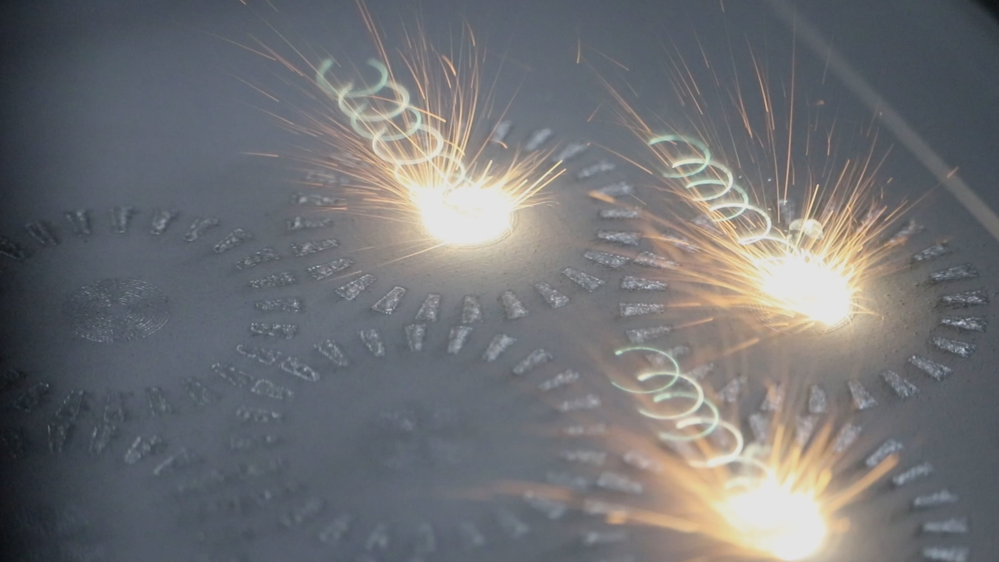

By speeding up the process by up to four times, the RenAM 500Q broadens the market appeal of metal additive manufacturing into applications that were previously uneconomic, driving the technology into new industries. The RenAM 500Q is designed to scale up AM technology to suit larger production volumes, enabling Permedica to use the system for mass production of standard parts instead of custom applications. Its working volume (250 x 250 x 350 mm) and four lasers enables the company to meet demanding production volumes and speeds. The system also features automated powder and waste handling systems that enable consistent process quality, reduce operator intervention time and ensure high standards of system safety.
Four 500W lasers enable RenAM 500Q to provide large volume production

Additively manufactured medical orthopedic components
