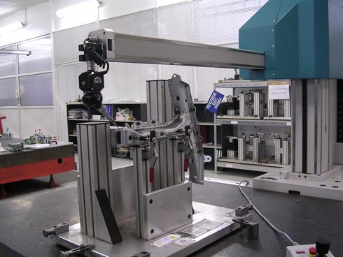

Inspection of components takes place on two automatic CMMs, typically taking 3 hours to measure complex parts. Multiple points are taken on critical surfaces, comparing measured values to CAD data.
Benefits of stylus changing
Because of the complexity of features, virtually every part needs both a straight and cranked stylus arrangement to make contact with all the specified points in one set-up (the stylus is the stem and ball attached to the end of the CMM's probe sensor). Renishaw's TP20 probe system, fitted to both CMMs, allows the stylus configuration to be changed in seconds, with no need to re-qualify the stylus tip's position.
Part measurement
The highly repeatable magnetic kinematic coupling allows the stylus module to simply 'snap' on and off whilst ensuring the tip is accurately re-positioned. Although the ability to swap manually between two stylus modules is the most basic use of the TP20, it has eliminated hours of manual, non-productive time on an expensive automated machine.

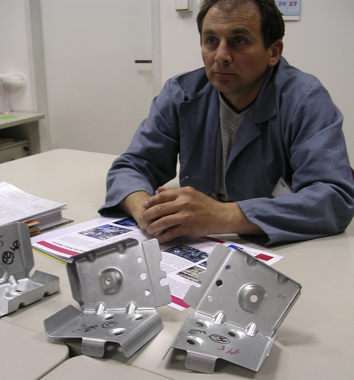

Finished pressed parts and other bought-in items, are all subject to sample inspection, to ensure compliance with the high tolerances demanded by their automotive customers. For each production run, 100% of the features on a sample part are inspected on the CMMs. If this part is within tolerance, then the rest of the batch, usually thousands of parts, will meet specification.
For example, 10 points are taken on a particular flange measuring 70 mm by 20 mm; if any vary from nominal position by more than 0.5 mm the part is rejected and production is halted. Flatness and form are very important, so inspection of features such as corner radiuses must be carefully controlled.
