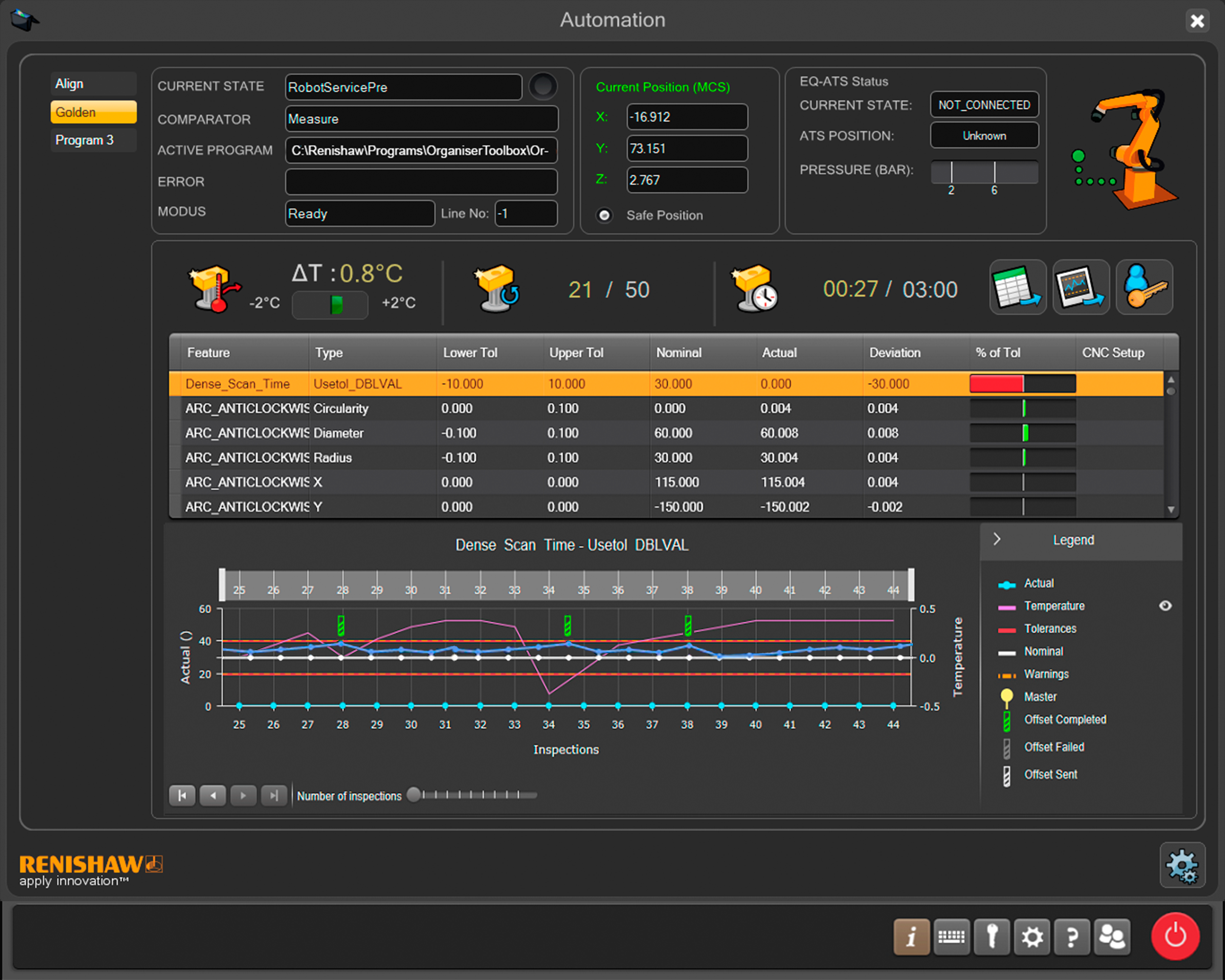

Process control is significantly improved with the move from sample inspection to 100% inspection, whilst the Equator system's Process Monitor function displays real-time gauging data bar graphs and charts, allowing for process corrections and scrap prevention.
Renishaw's Intelligent Process Control software (IPC) can record actionable data and provide automated real-time solutions, applying offset updates for common causes of instability such as tool wear and thermal drift.

The REN-IO interface unit, coupled with the EZ-IO automation software, allows the Equator gauge to connect to a variety of external equipment in an automated cell with up to 32 digital IO connections. EZ-IO software simplifies the setup of automated manufacturing cells to configure communications between Equator systems and the cell controller.
