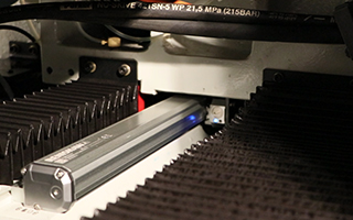

FORTiS™ enclosed encoder inside TGT's tool grinding machine

Tubular linear motors are employed on the crosswise X-axis and the longitudinal Z-axis of this machine with strokes of 300 mm and 680 mm, respectively. Both axes are equipped with the FORTiS-S™ enclosed encoder system, which is the standard-sized variant of the FORTiS encoder.

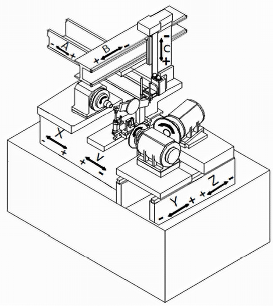

Microma Auto
Schematic of TGT's Microma Auto grinding machine
The Microma Auto is a cylindrical grinding machine used for the preparation of cutting tool blanks such as regular drills, endmills and profile tools, and comprises four linear axes (X, Y, Z and V).
Prior to machining, the tool blank is clamped by a collet on the workpiece spindle and identified by the LP2 probe system. During processing, the workpiece rotates within a V-shaped holding tool (V-block), which is mounted on the V-axis, while being driven along the longitudinal X-axis, which is the feed axis. As the workpiece enters the grinding station, it is fed between two grinding wheels (roughing and finishing wheels) that are driven along the Y and Z axes, respectively, and are perpendicular to each other. One advantage of the Microma Auto is that the whole process is completed in a single pass.
A kinematic feature of this machine is that the workpiece spindle axis (X-axis) and the V-block axis (V-axis) are on the same linear motor guideway but driven by separate linear servo motors.
The X-axis and V-axis slides are attached to separate FORTiS encoder readheads but use the same enclosed absolute scale of the FORTiS dual-readhead system. The readheads feedback the X-axis position of the workpiece and V-axis position of the V-block, each with a resolution of 10 nm, to the controller. In this case, the FORTiS encoder enables a positioning accuracy of 3 µm on an axis with 150 mm of travel.

FORTiS encoder readheads are equipped with Renishaw's patented set-up LED, and carefully designed installation accessories to ensure intuitive and right-first-time installation that is substantially faster than more conventional systems, even in restricted locations.
For enhanced functionality, installers can connect the Advanced Diagnostic Tool, ADTa-100, via a standard USB connector, to a PC running Renishaw's ADT View software. This provides a user-friendly graphical interface of advanced diagnostic information, including key encoder performance parameters such as signal strength along the axis length.
TGT technicians use the ADTa-100 hardware to connect the FORTiS encoder to the ADT View software interface during the machine assembly process. This software provides a snapshot of the real-time signal strength at different positions along a machine axis such that the technician knows where to make fine adjustments and can even enable calibration of the FORTiS encoder with the machine powered down.
