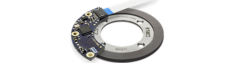

The main shaft of the Pan and Tilt device, which can rotate the sonar at 10 degrees per second, passes through the ring of the RLS AksIM encoder. The ring, which is magnetised and features an integral code pattern, does not touch the readhead board. No contact means no friction and hence no wear, making it reliable for remote, subsea applications. The RLS encoder offers resolution 10 times greater than demanded in Martech's application.

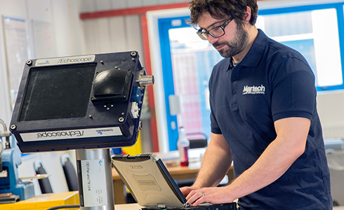

Martech's Pan and Tilt unit

Of course, deploying a sonar device down to 3000 metres underwater demands a rugged actuator unit that is able to withstand high pressures, cold temperatures and high hydrodynamic forces. To cope with such harsh environmental conditions, Martech created a specially designed housing.
“We are actually using a solid state oscillator as the clock; we cut out the crystal,” says Paul. “It's easy to do and it works very well. Renishaw have even drawn on our experiences to develop their own version of the encoder specifically for high pressure applications.”

AksIM magnetic rotary absolute encoder module
