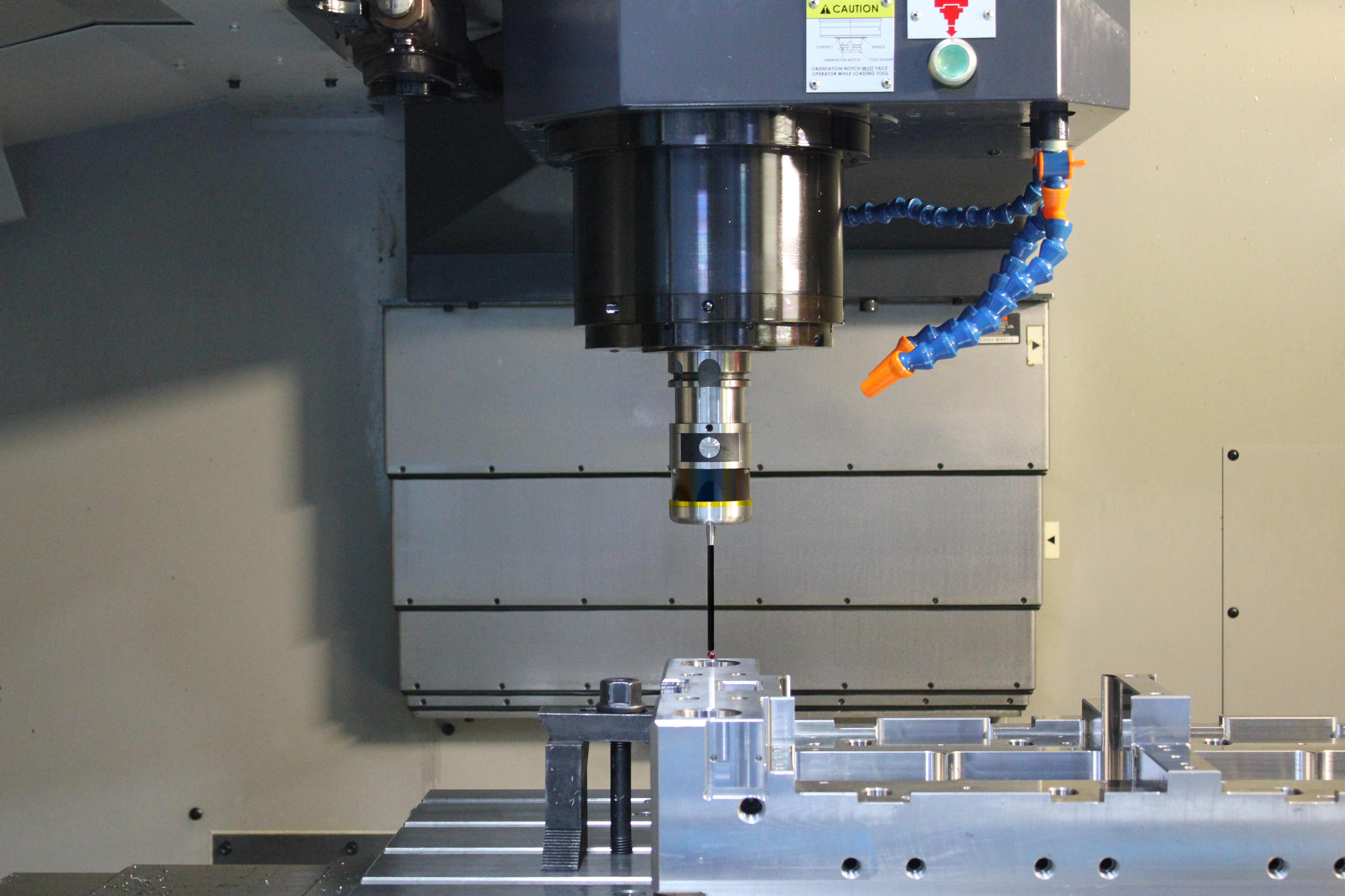

With the help of Renishaw's RMP600 touch‑trigger probeand TS27R tool setting technology, Vasantha Tool Crafts has successfully increased the utilisation of every one of its machine tools by 20%, and reduced part setting process time from one hour to just three minutes.

The company initially employed manual part and tool setting methods using dial gauges and a ‘tools via block' method. Setting using these methods took hours to complete as everything was dependent on individual operator skill and experience. After replacing these time consuming manual processes with automated Renishaw probing systems, Vasantha Tool Crafts has been able to optimise cycle times, thereby reducing costs and achieving significant improvements in quality and reliability.
Solutions implemented
Vasantha Tool Crafts installed the Renishaw RMP600 – a compact, high‑accuracy‑touch trigger spindle probe with radio signal transmission – to enable automated job set up. The company also installed the TS27R contact tool setting probe to enable broken tool detection and rapid tool length/diameter measurement.
As well as the significant reduction in part set-up time enabled by the RMP600, the implementation of the TS27R has also benefitted the company. It has reduced the time taken to set tool offsets by 80% and significantly decreased human error, leading to a reduction in scrap. Setting parts and tooling using Renishaw probes has increased productivity, throughput and machine up time, giving Vasantha Tool Crafts a competitive edge. The company has now decided to install Renishaw probing systems on all of its machines as part of its quality control policy.
