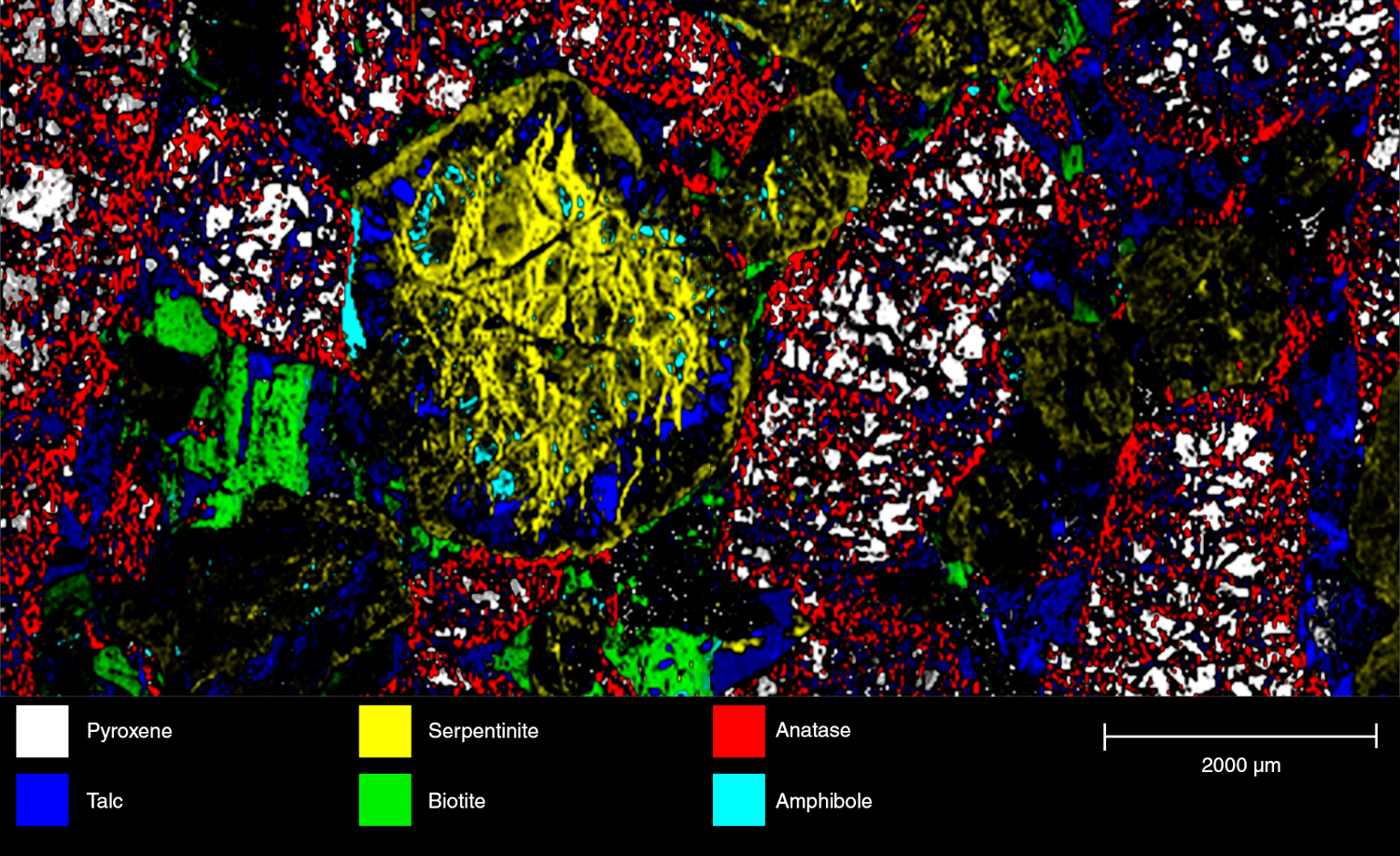

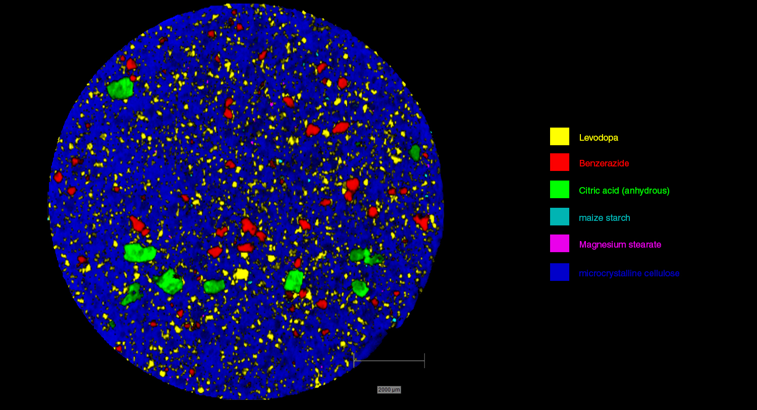

You can perform Raman spectral imaging to show the 2D and 3D spatial distribution of chemical species within a sample. As a result, you can better understand the chemical components within your sample. Most samples are not homogeneous; you need to know the size and distribution of their components to understand them fully. You can also determine the structural variation in a material, such as crystallinity, stress state or number of layers.

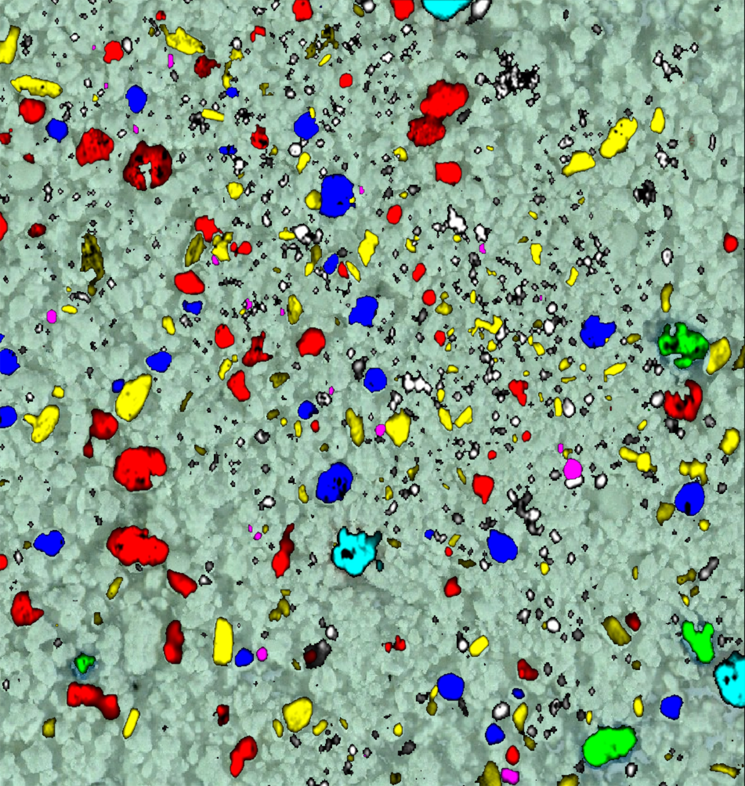

You can use StreamLine technology with Slalom mode to solve the problem of undersampling. If you use step (pixel) sizes that are larger than the width of the laser spot or line, Raman imaging might not detect smaller particles.
With Slalom mode, the laser line moves in a zig-zag motion to collect data from the entire region of interest. This helps to detect smaller features that you could have missed. Such small features could be monolayer graphene on a large wafer, forensic contaminants, semiconductor defects or SERS nanoparticles. For more information, please read (PN on fast Raman imaging)
