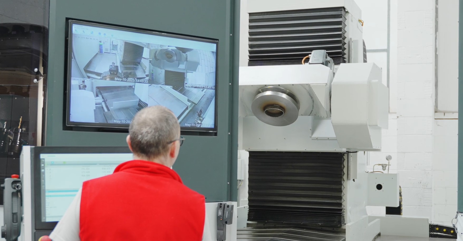

Hybrid machine toolEffective CNC's hybrid additive and subtractive machine tool

The team at Effective CNC has designed and built an ‘all-in-one' machine that can perform both additive and subtractive machining operations in tandem. This, they claim, will help to revolutionise the economics of many large, precision AM metal builds.
Gary Pearson, Director of Effective CNC, explains the unique features of the new machine:
“We created a fixed rigid position for a spindle, a wire deposition additive manufacturing head and, in this machine, a turning turret.
We can move the workpiece around in all five axes and take it between the various stations to add and subtract and add and subtract, without having to move the actual tooling around.
We took a wire deposition additive manufacturing system, which is basically a very clever MIG welder, and put it onto the machine in a fixed position. This allows us to add the base material onto a clean build plate and then machine it back without having to take the product off the machine.
Because we can add material in five axes on the machine, we can build very complex shapes and machine them back to very accurate tolerances without having to take them off the machine at all."
Another innovative feature of this machine is that it incorporates three cutting processes - milling, turning and grinding - in addition to additive processing, enabling an additively manufactured part to be built and finished on a single machine.
The basic machine design comprises a holder for a workpiece, a spindle for milling and grinding the workpiece, and a rotatable tool turret. A trunnion table supports the build plate and provides the 4th and 5th axes of the machine.
