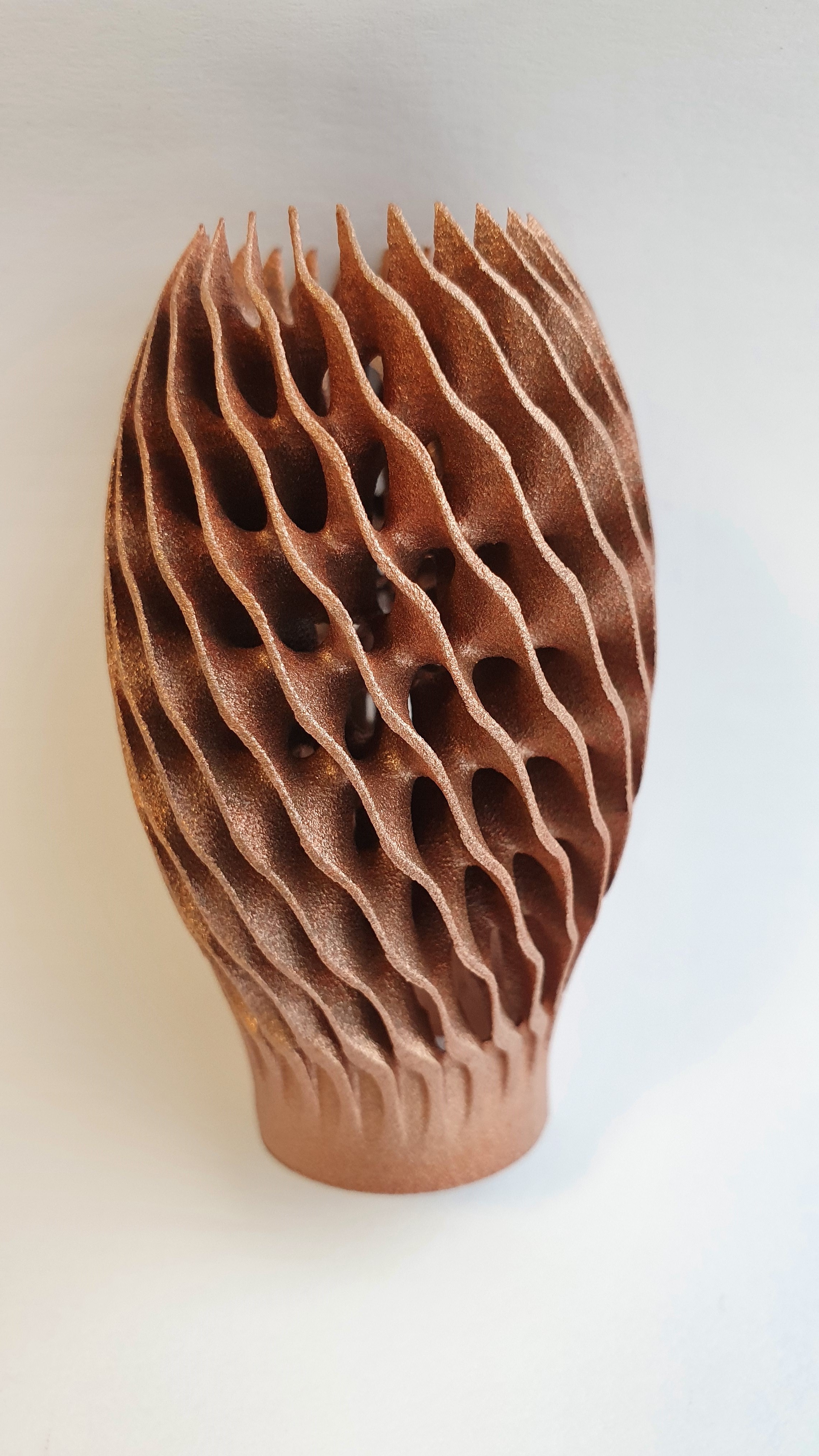

Combining Renishaw's RenAM 500S additive manufacturing system and nTopology software demonstrated an easy method for designing intricate structures that are suitable for use in heat exchangers and how it can be integrated with Renishaw's build preparation software, QuantAM. At New Mills, our headquarters in Gloucestershire, UK, a RenAM 500S system, with a single 500 Watt laser and 70um laser spot size, was loaded with 99.9% pure copper powder supplied by Carpenter Additive. The system was optimised to work with this material. The system was able to manufacture thin walls with a thickness of 0.35 mm and solids with a density over 98 per cent, prior to heat treatment in 30 micron layers.
Designing triply periodic minimal surfaces in nTopology's nTop Platform
nTopology software was used to generate triply periodic minimal surfaces (TPMS) that are ideal for heat exchangers as they generally require the amount of surface area within a given volume to be maximised. The design critieria for the TPMS gyrold structure was for a wall thickness of 0.35 mm and cell sizes of 2 and 5 mm. The nTopology software was used to slice the design into 30 micron layers and export the boundaries and hatches as CLI files. These were then imported into Renishaw's QuantAM software to generate the build file for the AM process. Using CLI files removes the need for the traditional STL file format which has many disadvantages when used to describe complex intricate structures like these.
