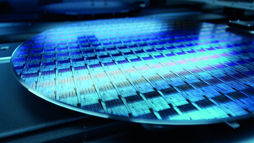

Selecting UHV-compatible encoders for demanding semiconductor and scientific applications
Many high-end semiconductor manufacturing processes require the processing environment to be completely free of any contaminants that cause imperfections within the semiconductor wafer and transistors being created. As the semiconductor industry moves to smaller feature sizes, larger wafers and more complex components with more processing steps, acceptable levels of wafer contamination are increasingly small.
These critical industrial processes take place in a vacuum because the presence of significant amounts of air or other gases would be detrimental to the finished product. Processes like semiconductor manufacturing that demand precision motion control need vacuum-compatible optical encoders for position feedback. Locating the position encoders within the vacuum chamber ensures that the measurement device is as close to the working environment as possible, ultimately minimising errors.
Semiconductor FABSemiconductor fab
Semiconductor wafer during productionSemiconductor wafer during production

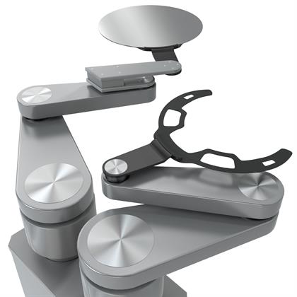

Wafer handling
Semiconductor wafers are fragile and expensive, and they must be handled with care so that they are not damaged during the manufacturing process. Consequently, wafer handling robots are commonly used to move semiconductor wafers inside process equipment.
A wafer-handling robot has multiple degrees of freedom and consists of a body, an arm with multiple joints, and a wafer holding tool (paddle). Handling robots typically move a wafer from one transfer chamber to another or between process steps and their throughput has a direct impact on the overall performance of semiconductor fabs.
The straight line and angular motions of a handling robot must be accurate to avoid any contact that might result in either damage or contamination of the wafer surface.
Robot arm control is achieved with a motorized upper arm pulley and upper-arm spindle that drive a series of endless belts, which link the shoulder joint to the elbow and wrist joints of the arm.
A master-slave relationship requires that position commands for one motor are determined by position feedback from the other.
Wafer handling robotWafer handling robot
Encoder requirements for wafer handling robots:
  • Absolute encoders may be preferred to eliminate the need for datum homing cycles and ensure that payloads remain under control even after power outages.
  • High quality position encoder feedback with low cyclic error is needed to ensure minimal toque ripple for smooth velocity control and high precision.
  • Encoders with position checking algorithms and additional safety features to guard against common-cause failures.
  • Absolute or incremental encoders that offer high resolution at high operating speeds.
  • Encoder systems with dual analogue and digital output signals to synchronise the operation of wafer grippers or calibration cameras.
  • Encoders with UHV capability if appropriate.
Encoder solutions for wafer handling
RESOLUTE™ UHV encoders bring absolute encoder technology to ultra-high vacuum applications down to 10-9 Torr, allowing customers to achieve higher throughput, reduce risks of damage and increase dependability.
RESOLUTE encoders offer outstanding metrology performance in UHV applications with resolutions down to 1 nm at a wide range of speeds.
TONiC UHV encoders are suitable for UHV conditions and use filtering optics and dynamic signal processing to give low Sub-Divisional Error which enables highly precise motion control.
RESOLUTE UHV rotary and linear encoder systemsRESOLUTE UHV rotary and linear absolute encoder systems
Both the TONiC UHV and RESOLUTE UHV encoder ranges also offer a functionally safe variant for systems requiring Functional Safety certification to SIL2 and PLd.
