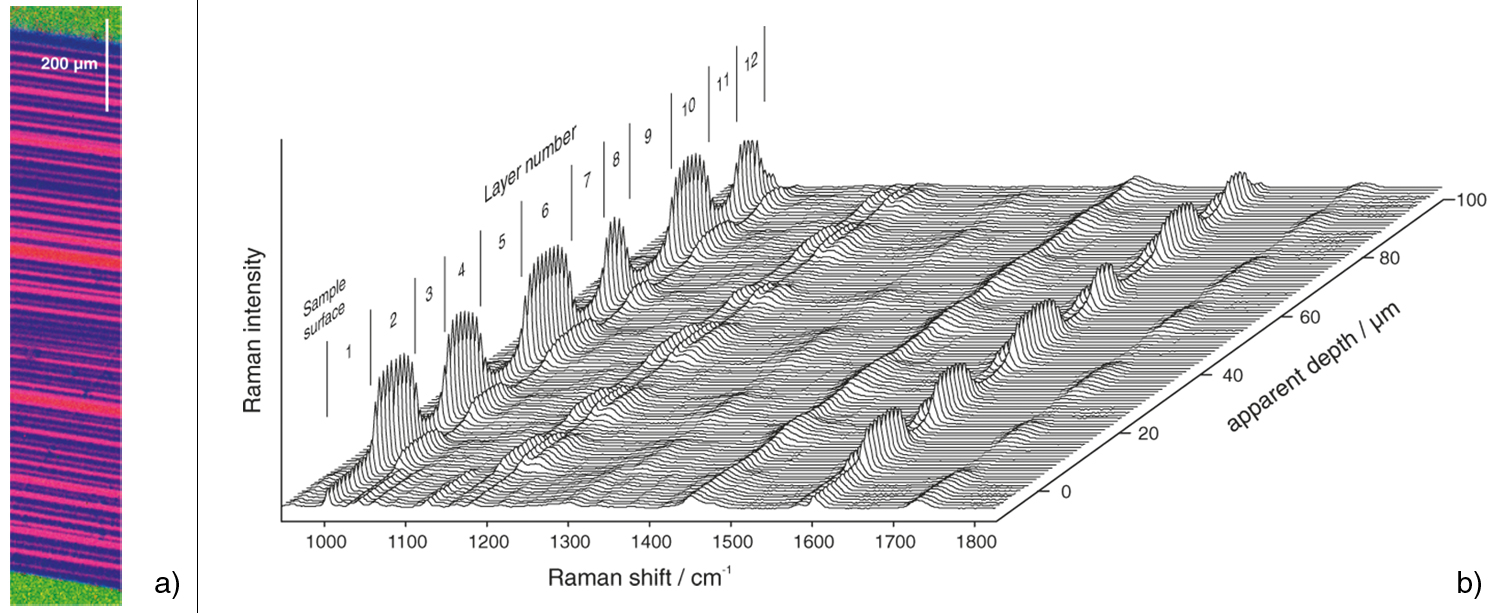

  • the thickness and composition of layered materials, such as polymer laminates, from micrometres to millimetres thick

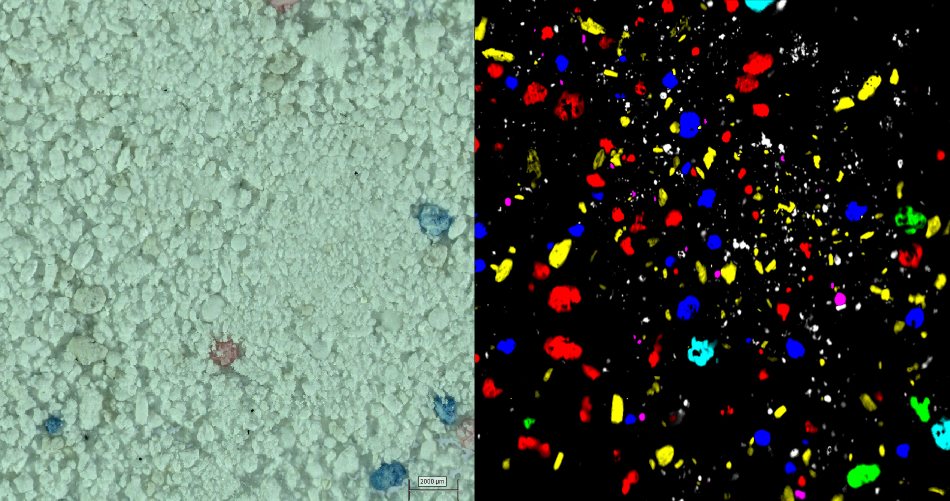

White light and Raman images of washing powder
White light and Raman images of washing powder. The Raman images show chemically different domains which are not visible in the white light image.

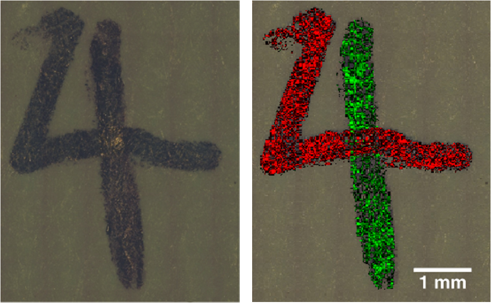

False colour Raman images are a powerful way to emphasize the distribution of chemical and structural properties within a sample. The brightness, contrast and colour of the image can help to represent material composition. By overlaying individual Raman images, you can display the distribution of multiple species or properties at the same time.

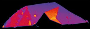

SiC wafer
Raman image of a SiC wafer. The images area is approximately 1 mm2, and shows inclusions of 6H-Silicon carbide, 3C-Silicon carbide or Si (red), voids (black). The strain distribution is shown as blue to green.

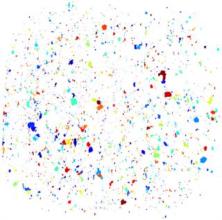

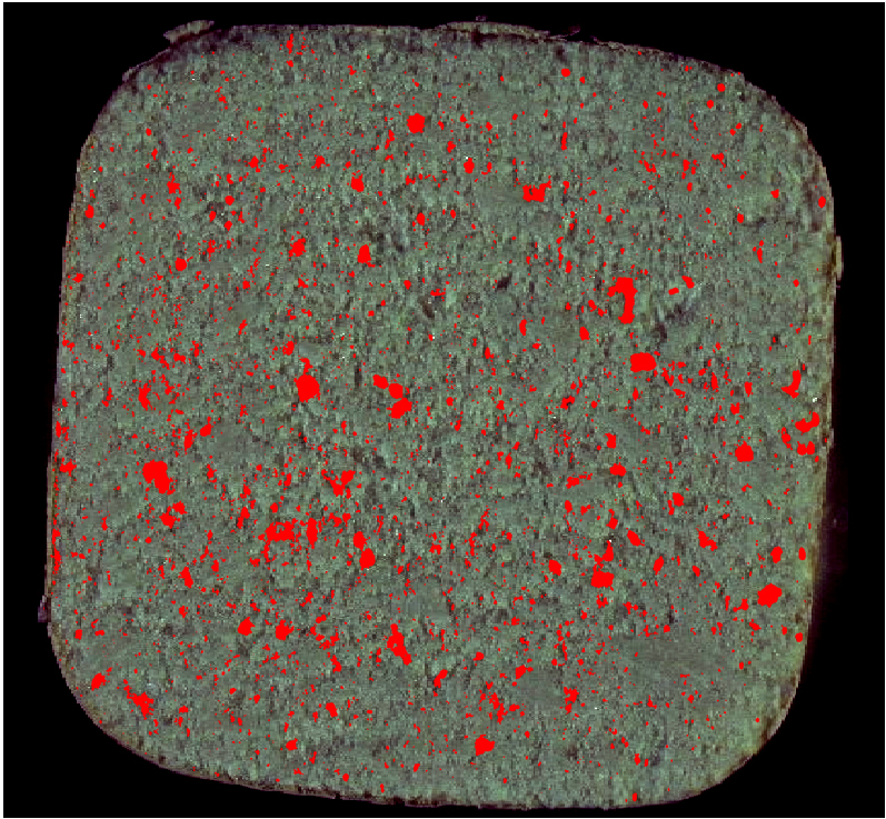

Binarised Raman image of montelukast sodiumRaman image of montelukast sodium API within an oral tablet. API domains are shown in different colours for easy visualisation.
You can also analyse Raman images to get quantitative data. This includes particle statistics metrics like number of particles, shape or size. In this way, you can quantify Raman images with objective metrics for direct comparison.

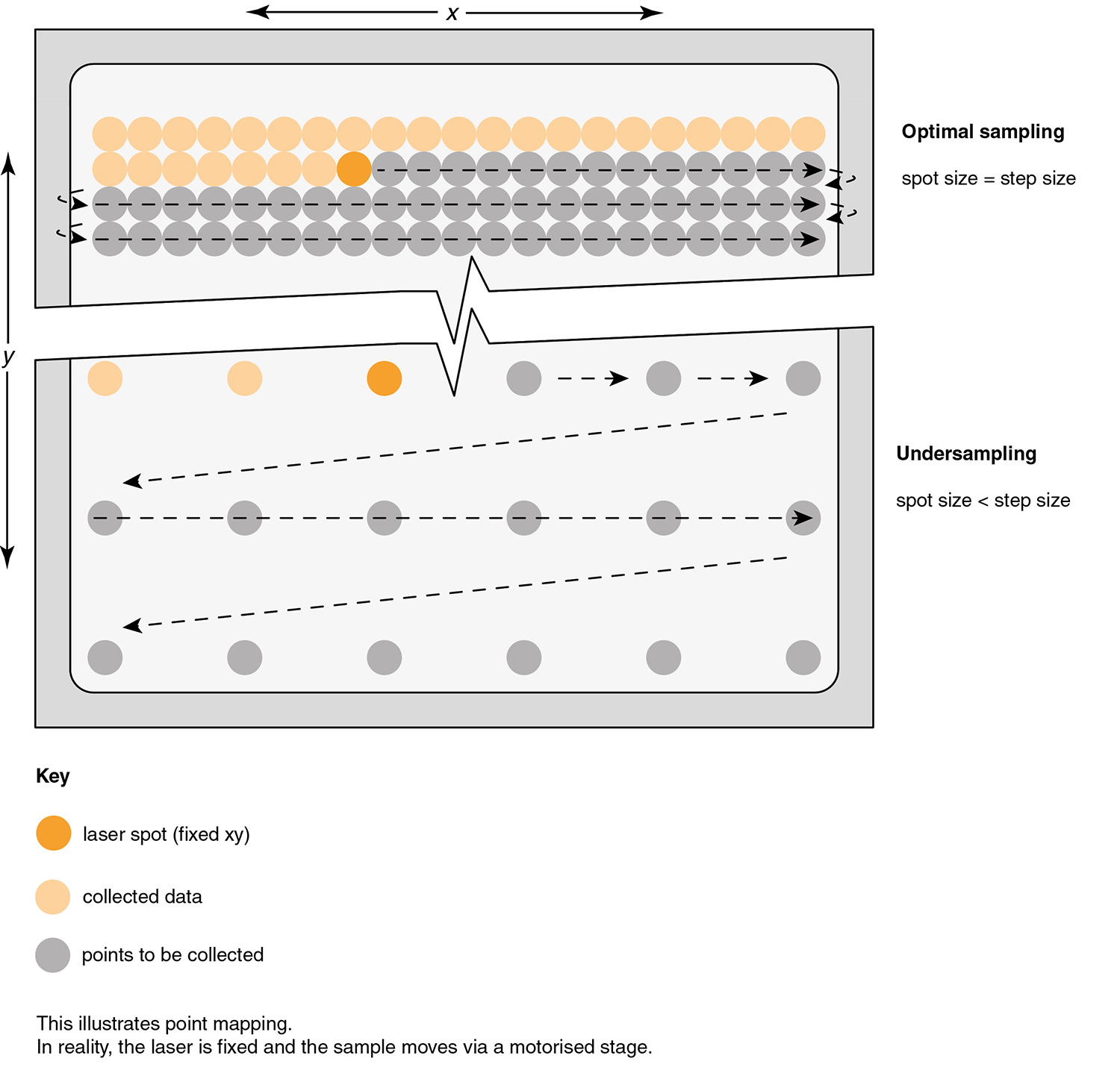

Optimal sampling and undersampling
Diagram showing point-by-point imaging, depicting both optimal imaging and undersampling.
Line focus
The laser illuminates a line on the sample, rather than a spot. This enables you to simultaneously collect spectra from multiple positions on the sample, saving time. With this method you can use higher total laser powers without damaging the sample. Renishaw's StreamLine™ imaging technology is a sophisticated modern implementation of this concept. With line focus imaging, the laser illuminates a vertical line on the sample rather than a spot.

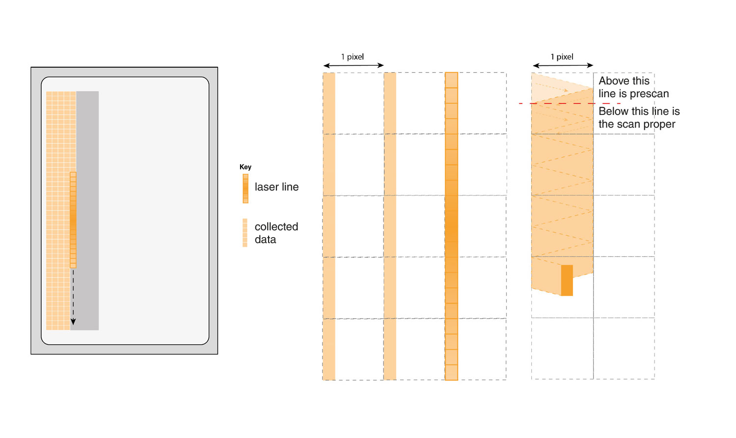

When imaging, it is important to consider the potentially undesirable effects of undersampling. Undersampling occurs if the laser spot or line is smaller than the spacing between acquisition points. Renishaw has solved this problem using StreamLine technology with Slalom mode.
StreamLine™ Slalom
Streamline™ imaging technology with Slalom mode ensures complete sample coverage, even when using large step (pixel) sizes. You can perform fast Raman imaging of large samples without missing anything.
StreamLine technology for fast yet gentle Raman imaging
The system scans the laser line across the sample along the y-axis. The CCD detector simultaneously collects data from multiple points on the sample.
The step size in x is equal to the width of the laser line. This method results in complete coverage, but not at the fastest speeds.
Undersampling without Slalom mode
The step size in x is greater than the width of the laser line. The laser line does not scan between the pixels so the spectrometer will not analyse some areas of the sample. In this illustration, the system only collects data from ~20% of the sample.
Streamline technology with Slalom mode for fast and complete coverage
The zig-zag motion of the laser line scans sample areas that are between the pixels. This enables a step size in x that is greater than the width of the laser line.
The spectrometer now collects data from 100% of the sample at the fastest speeds.

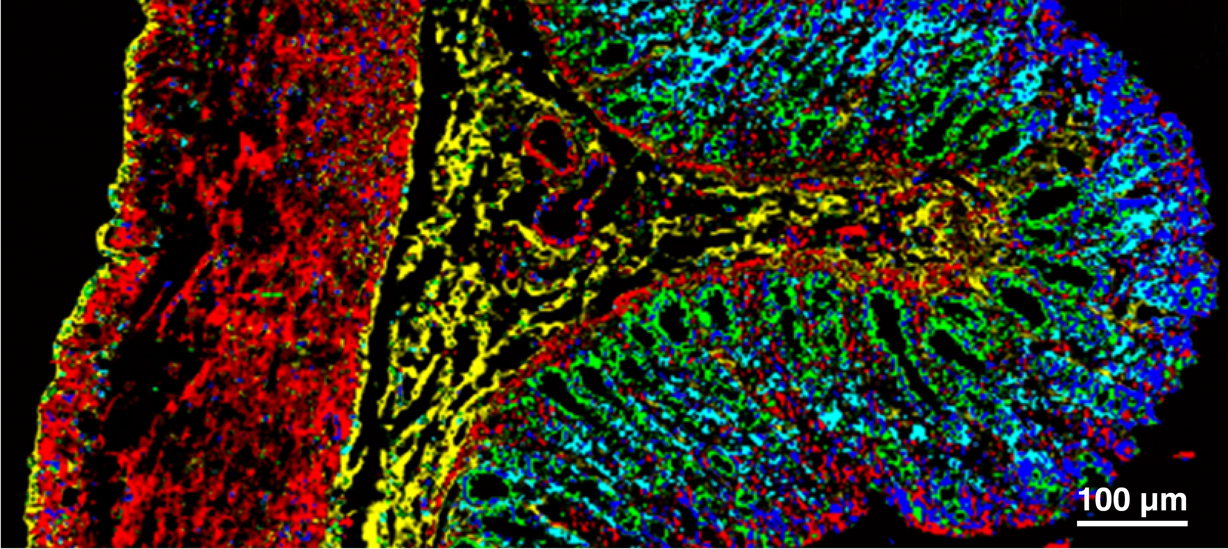

Rat colon
A Raman image shows the tissue organisation within a healthy rat colon crypt. PCA was used to create this image.
