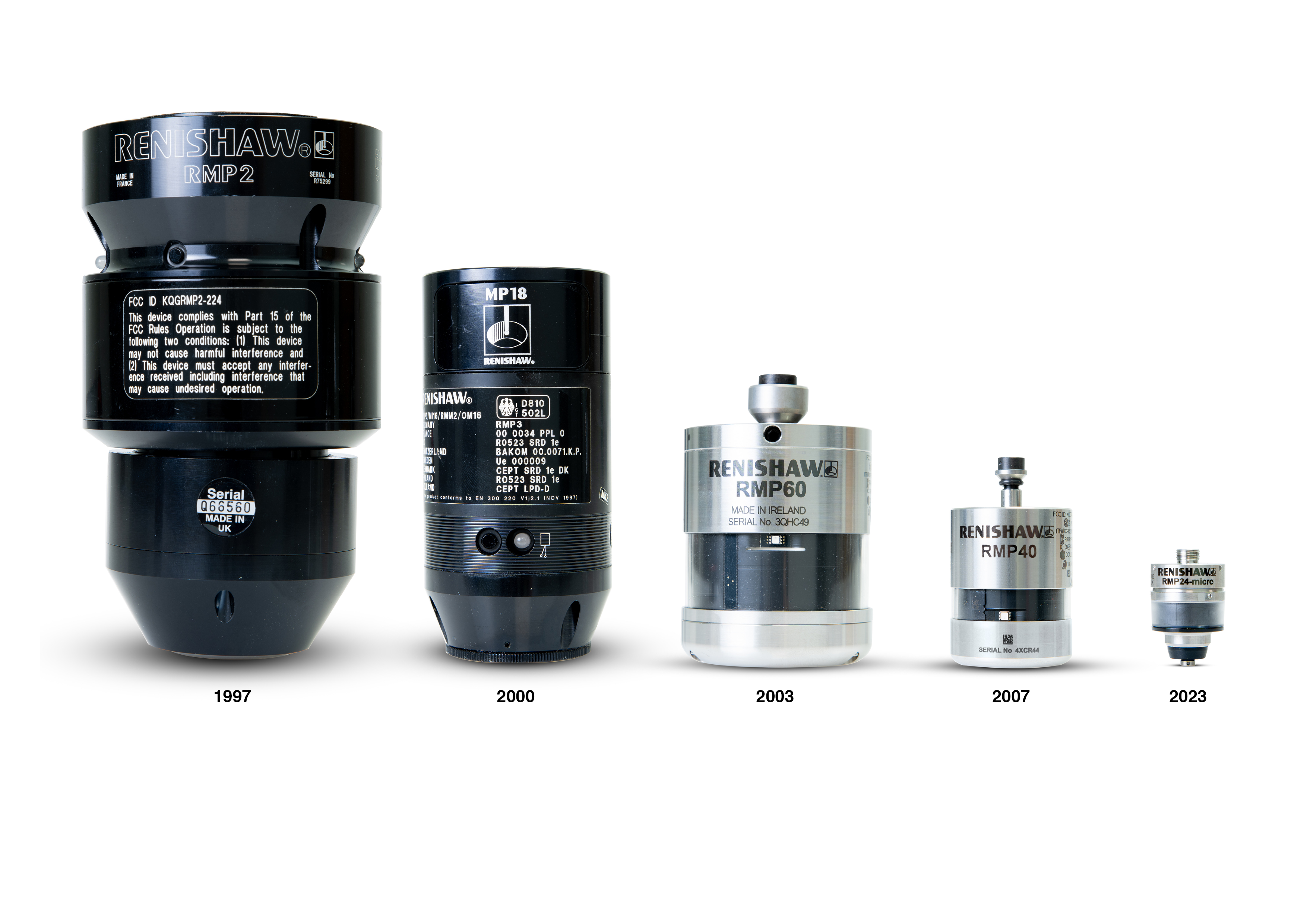

Size comaparison of Renishaw machine tool probes with radio transmission (past and present)
[3.0MB]

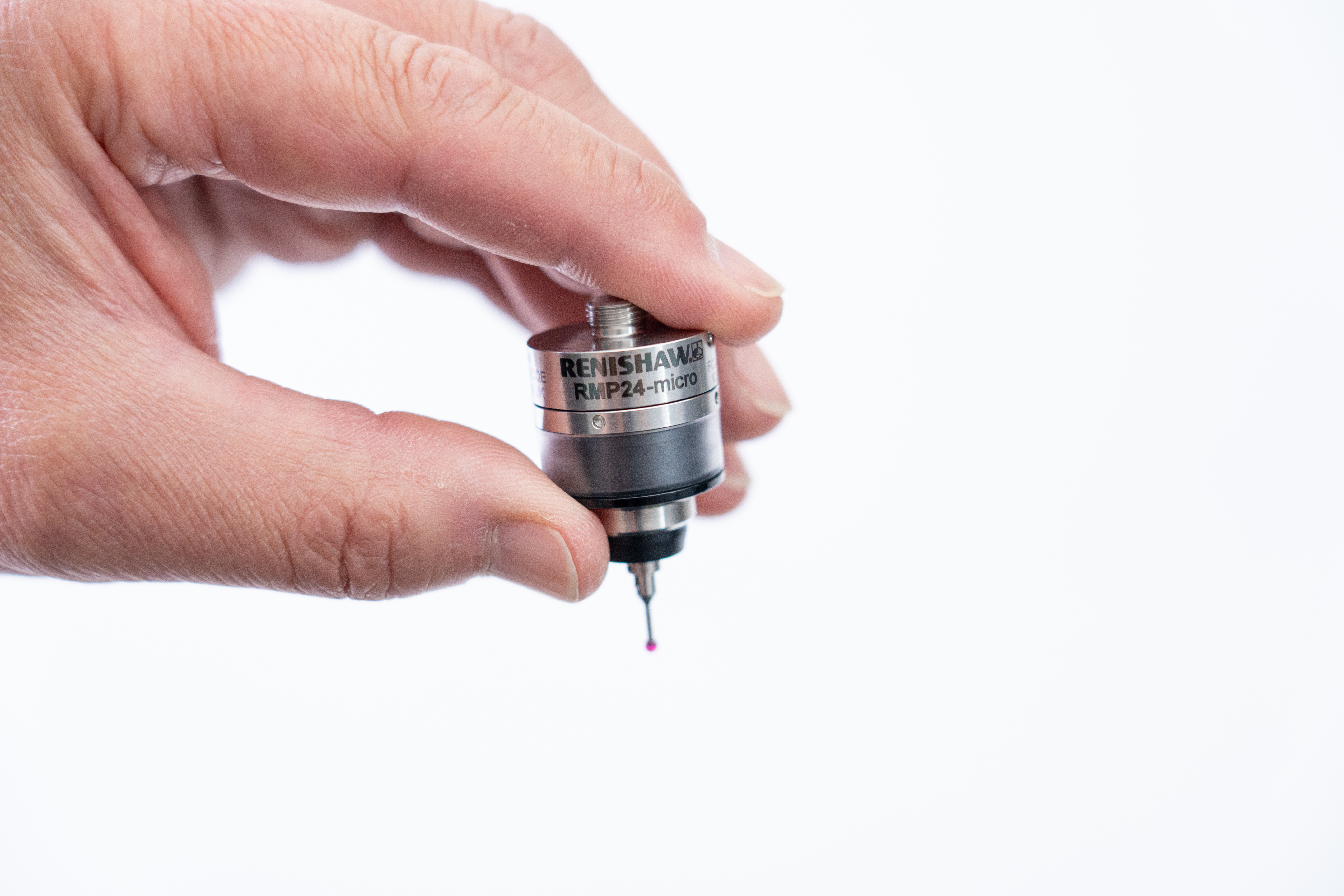

Eine Hand, die den RMP24-micro hält [gen]
[5.3MB]
