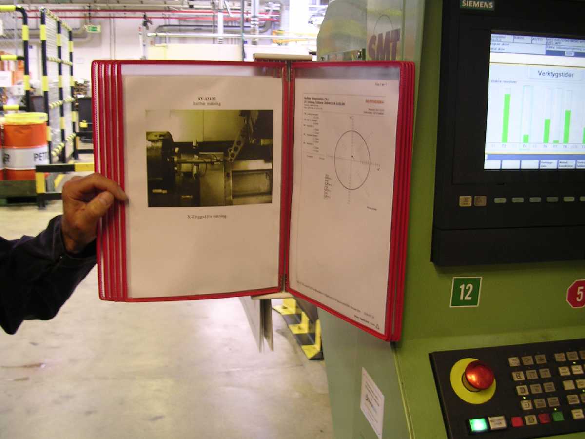

 Scania Dynamate - Ballbar history [gen] Scania Dynamate - Ballbar history [gen]Every machine has clear instructions, with pictures, to ensure test conditions are consistent across the factory [69kB]
