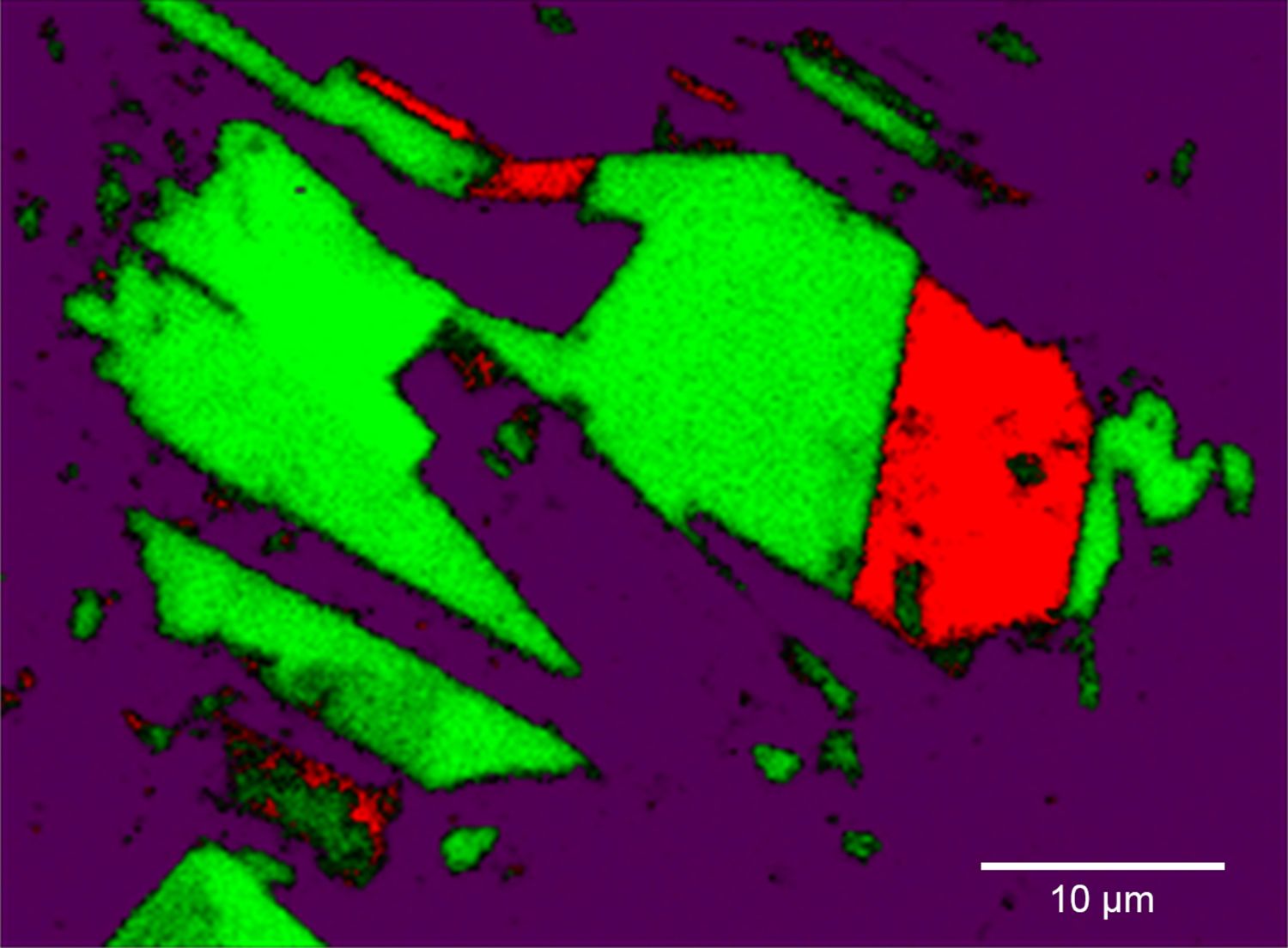

  • White light image of graphene
  • Raman image of graphene
White light and Raman images of graphene flakes on a silicon substrate. The Raman image is colour coded by number layers in the graphene: single-layer (red); dual-layer (blue); and multi-layer (green).

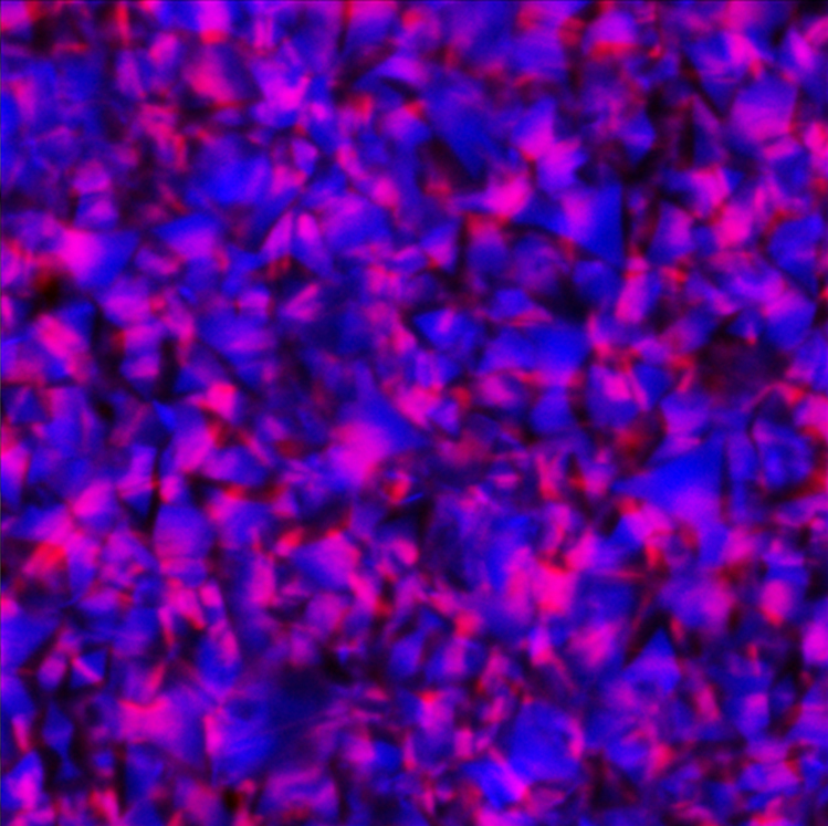

Raman and photoluminescence images of a hot-filament-grown CVD diamond film.
The Raman image indicates the intensity of the 1332 cm-1 diamond band. Darker regions have higher graphitic content; this leads to lower laser penetration and a weaker diamond signal.
The photoluminescence image is based on the intensity of the 1.77 eV band (red, most likely related to contamination from the filament during growth) and the intensity of the 1.95 eV band (blue, [N-V]- nitrogen vacancy).
