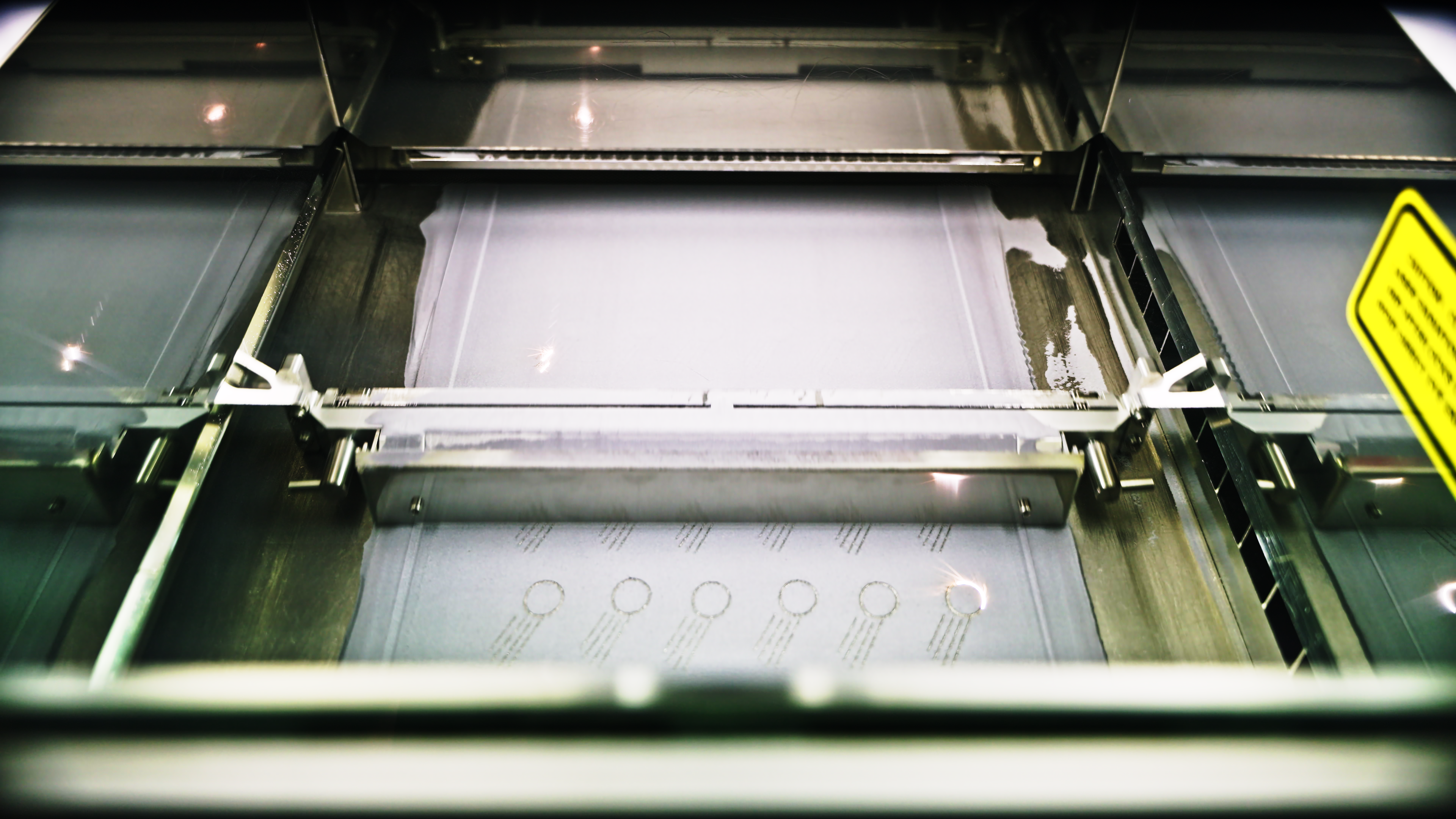

There are other approaches to driving productivity on an AM system that don't involve increasing bed size. Technologies that increase laser on time, turn machines around quickly, and simplify powder handling, can greatly improve productivity. For example, building powder handling processes, like sieving, into the machine so that unmelted powder doesn't have to be removed to be recirculated, can remove additional processing time. Some manufacturers are also incorporating vacuum processes into their machines that enable the system to start processing earlier, by more quickly removing oxygen, while reducing the consumption of argon gas.
One of the biggest issues with laser on time on a laser powder bed fusion machine is recoating time, which has historically had a negative impact on build speed, because the laser stops firing while the recoater is moving. When building thousands of layers, a recoating time of around nine to eleven seconds per layer can add up to tens of hours over an entire build. Renishaw's TEMPUS™ Technology has overcome this and can reduce build time by up to 50 per cent.
