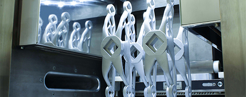

Bleu car bracket in AM 400 build chamber
Results
As a direct result of the collaboration between Dassault Systèmes and Renishaw, 3DEXPERIENCE platform users can now print directly to the complete range of Renishaw AM systems from within the existing native CAD environment. There is no need to export data files to an external system for additional post-processing.
The enhanced CATIA, SIMULIA and DELMIA applications mean that innovative 3D product designs are now automatically optimised for both manufacture on Renishaw AM systems, and end functional performance. As a result, parts are produced more accurately from the outset, bringing lead time and material cost savings.
The focus of attention for the 3D design software developments and the ultimate by-product of the project, the conceptual hinge for the ‘Bleu' concept car, also provided further real-world evidence of the benefits to be achieved by 3D design and printing. The CATIA product design design is shown in the image in the "challange" section. The finished aluminium printed part is itself shown in the image shown in the "solution" section.
While in this case the original and optimised part volumes were virtually identical, all of the support structures were removed from the hinge design, creating a more elegant, more reliable and yet far simpler automotive product.
