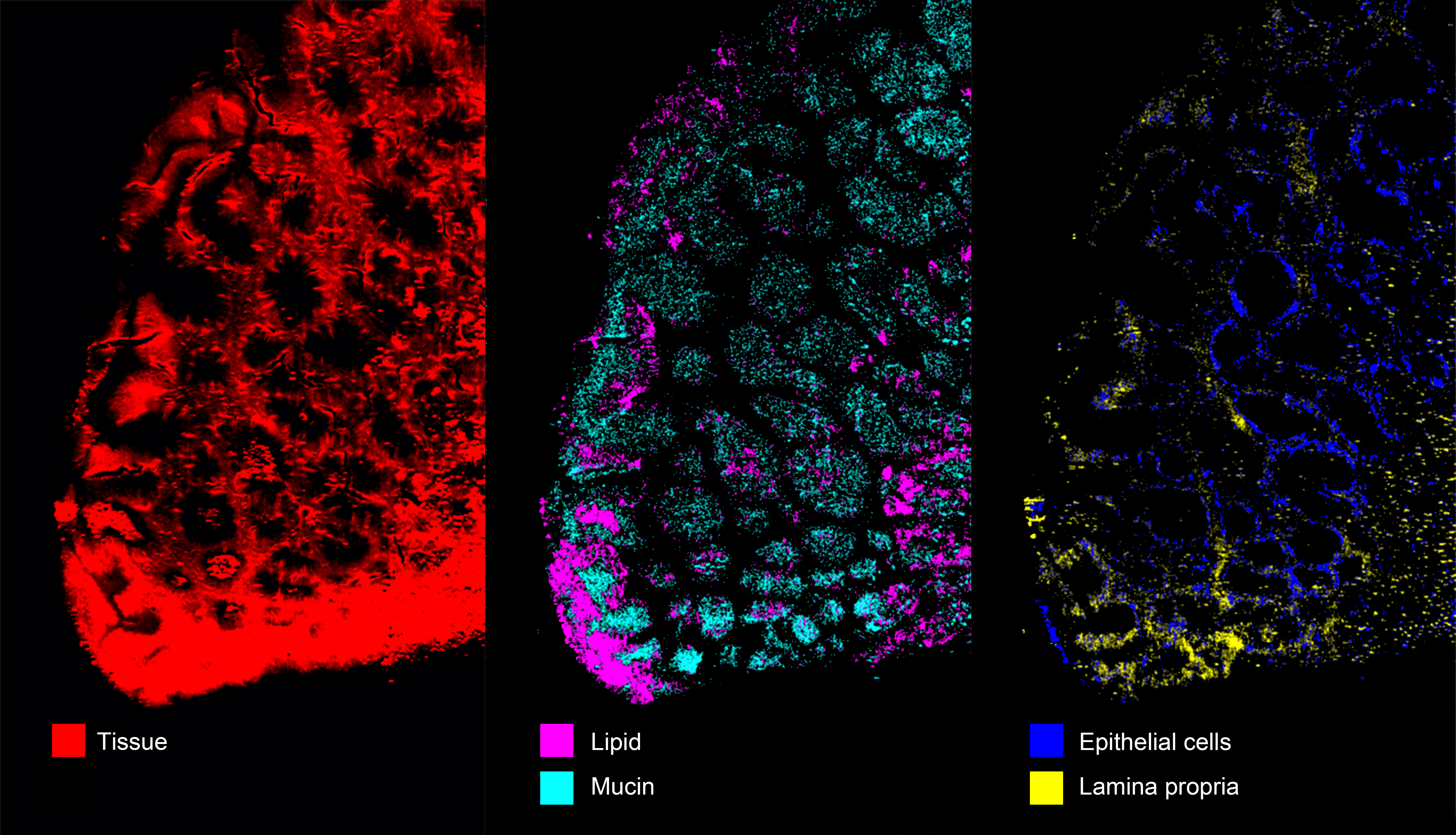

  • Streamline image of human oesophagus
